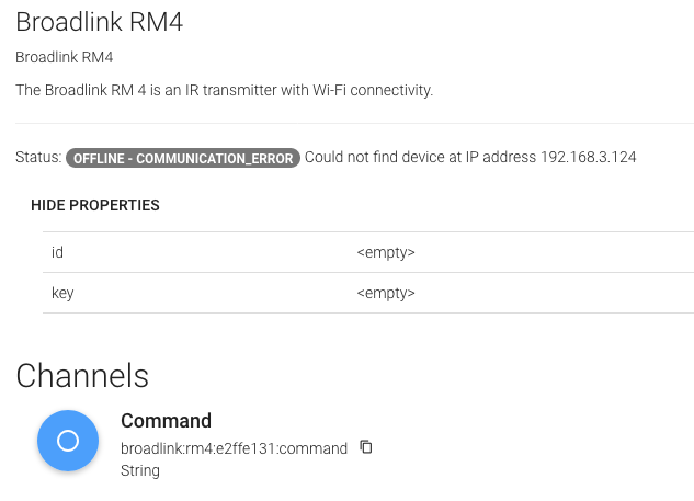

Hello everyone,
I’ve read as much as possible all the replies of this post and I hope I’ve not missed the answer to my question.
I’ve a R4 Mini.
With the help of the python script found here, with a little bit of modifications, I’ve successfully configured the WiFi on the device and got the values that I need to put in the config part of your addon.
DevType: 0x62bc -> 25276
IV: 562e17996d093d28ddb3ba695a2e6f58
Key: 8c393262037dfc87fd511150db7133dd

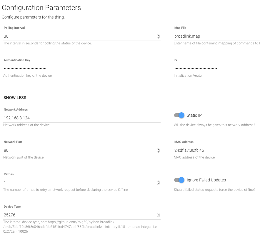

So I’ve installed the addon on my OpenHAB server, manually configured the Thing object (manually because my server and my wifi are on different subnets) and finally I got these output on the OpenHAB log:
2020-05-19 18:39:10.309 [me.event.ThingUpdatedEvent] - Thing 'broadlink:rm4:e2ffe131' has been updated.
2020-05-19 18:39:10.333 [ERROR] [handler.BroadlinkRemoteModel4Handler] - rm4:e2ffe131[v]: Could not get status: Response from device is not valid. (0x22=0xFB,0x23=0xFF,0x24=0xBC)
2020-05-19 18:39:10.333 [ERROR] [handler.BroadlinkRemoteModel4Handler] - rm4:e2ffe131[v]: Device became reachable but had trouble getting status. Marking as offline ...
2020-05-19 18:39:10.333 [ERROR] [handler.BroadlinkRemoteModel4Handler] - rm4:e2ffe131[v]: updateItemStatus: Online -> Offline
In addition, I’ve the same issue of @hafniumzinc: although I entered the IV and Key on the configuration section, when I click on Show Properties the values are empty
This is my Thing configuration.
Hope you can drive me to the right configuration! :smiley:

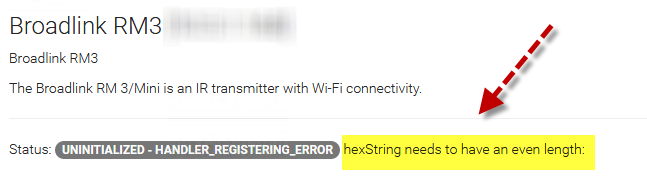

Well I installed the new Beta 8 and now see the following:
Any thoughts?
2020-05-20 01:09:09.993 [INFO ] [g.discovery.internal.PersistentInbox] - Added new thing 'broadlink:rm3:78-0f-77-1a-13-38' to inbox.
2020-05-20 01:09:19.870 [ERROR] [core.thing.internal.ThingManagerImpl] - Exception occurred while calling thing handler factory 'org.openhab.binding.broadlink.internal.BroadlinkHandlerFactory@7327d42a': hexString needs to have an even length:
java.lang.IllegalArgumentException: hexString needs to have an even length:
	at org.eclipse.smarthome.core.util.HexUtils.hexToBytes(HexUtils.java:105) ~[bundleFile:?]
	at org.eclipse.smarthome.core.util.HexUtils.hexToBytes(HexUtils.java:119) ~[bundleFile:?]
	at org.openhab.binding.broadlink.handler.BroadlinkBaseThingHandler.<init>(BroadlinkBaseThingHandler.java:69) ~[?:?]
	at org.openhab.binding.broadlink.handler.BroadlinkRemoteHandler.<init>(BroadlinkRemoteHandler.java:46) ~[?:?]
	at org.openhab.binding.broadlink.internal.BroadlinkHandlerFactory.createHandler(BroadlinkHandlerFactory.java:56) ~[?:?]
	at org.eclipse.smarthome.core.thing.binding.BaseThingHandlerFactory.registerHandler(BaseThingHandlerFactory.java:126) ~[bundleFile:?]
	at org.eclipse.smarthome.core.thing.internal.ThingManagerImpl.doRegisterHandler(ThingManagerImpl.java:587) [bundleFile:?]
	at org.eclipse.smarthome.core.thing.internal.ThingManagerImpl.registerHandler(ThingManagerImpl.java:564) [bundleFile:?]
	at org.eclipse.smarthome.core.thing.internal.ThingManagerImpl.registerAndInitializeHandler(ThingManagerImpl.java:1056) [bundleFile:?]
	at org.eclipse.smarthome.core.thing.internal.ThingManagerImpl.thingAdded(ThingManagerImpl.java:445) [bundleFile:?]
	at org.eclipse.smarthome.core.thing.internal.ThingRegistryImpl.notifyTrackers(ThingRegistryImpl.java:211) [bundleFile:?]
	at org.eclipse.smarthome.core.thing.internal.ThingRegistryImpl.notifyListenersAboutAddedElement(ThingRegistryImpl.java:131) [bundleFile:?]
	at org.eclipse.smarthome.core.thing.internal.ThingRegistryImpl.notifyListenersAboutAddedElement(ThingRegistryImpl.java:1) [bundleFile:?]
	at org.eclipse.smarthome.core.common.registry.AbstractRegistry.added(AbstractRegistry.java:157) [bundleFile:?]
	at org.eclipse.smarthome.core.common.registry.AbstractRegistry.added(AbstractRegistry.java:1) [bundleFile:?]
	at org.eclipse.smarthome.core.common.registry.AbstractProvider.notifyListeners(AbstractProvider.java:56) [bundleFile:?]
	at org.eclipse.smarthome.core.common.registry.AbstractProvider.notifyListeners(AbstractProvider.java:75) [bundleFile:?]
	at org.eclipse.smarthome.core.common.registry.AbstractProvider.notifyListenersAboutAddedElement(AbstractProvider.java:79) [bundleFile:?]
	at org.eclipse.smarthome.core.common.registry.AbstractManagedProvider.add(AbstractManagedProvider.java:64) [bundleFile:?]
	at org.eclipse.smarthome.core.common.registry.AbstractRegistry.add(AbstractRegistry.java:325) [bundleFile:?]
	at org.eclipse.smarthome.config.discovery.internal.PersistentInbox.addThingSafely(PersistentInbox.java:630) [bundleFile:?]
	at org.eclipse.smarthome.config.discovery.internal.PersistentInbox.approve(PersistentInbox.java:203) [bundleFile:?]
	at org.eclipse.smarthome.io.rest.core.internal.discovery.InboxResource.approve(InboxResource.java:104) [bundleFile:?]

I’m seeing the same “UNINITIALIZED - HANDLER_REGISTERING_ERROR hexString needs to have an even length:” message when using beta 8.
[EDIT] Like @KidSquid, I also followed all the steps prior to installing beta 8 and I got the hexString error message.
@themillhousegroup
I have followed your steps outlined above to the letter, and I still receive the “hexString needs to have an even length” error.
Please advise…
Also curious why the version number regressed…earlier versions were 2.5.3 and this version is 2.5.1???

Based on the logging/stack traces you’ve shared here, I can see the problem exists in the Authentication Key that you enter in the Thing configuration and is used to initially communicate with the device during Thing creation.
I’ve released BETA 8.1 which has increased logging around the Thing creation:
https://github.com/themillhousegroup/openhab2-addons/releases/download/BROADLINK_2.5.BETA_08.1/org.openhab.binding.broadlink-2.5.1-SNAPSHOT.jar
Specifically it will actually show you what it thinks the Authentication Key you’ve supplied is (i.e. the poorly-kept “secret key” that has been mentioned so many times in this thread :laughing: )
In testing this small feature I was able to very easily get openHAB into a weird “out-of-sync” state where the key I’d entered into PaperUI did not reflect what the device was using, and could not be fixed without deleting the relevant Thing so hopefully this new logging (which logs at a higher INFO level so should always be visible) will you help diagnose it too.
In my testing, the only reliable way to get out of this situation is to force-delete the Thing, restart OpenHAB, discover the Thing again and carefully paste in the configuration values:
Authentication Key
097628343fe99e23765c1513accf8b02
IV
Hope this helps!
