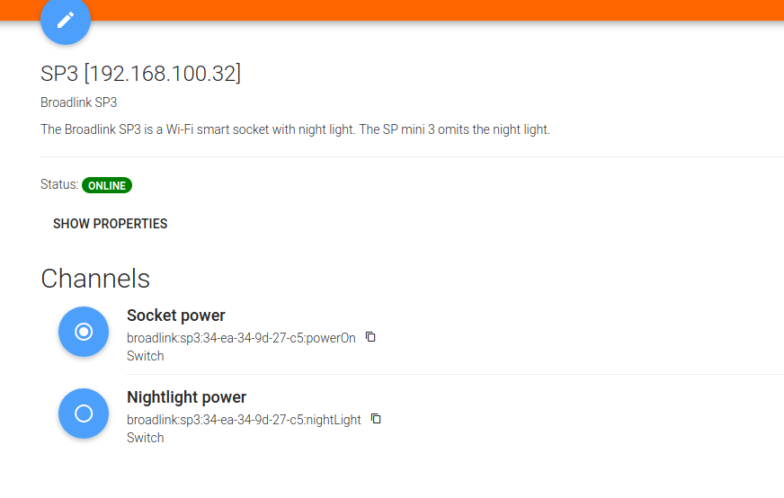

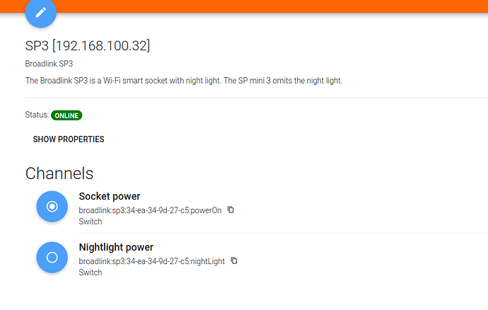

Im trying to connect two SP3S. Im using the last addon org.openhab.binding.broadlink-2.5.9.jar. The problem is probably that it recognizes the Thing as SP2 or SP3 without ‘S’ because i dont have a Nightlight but Power consumption:
