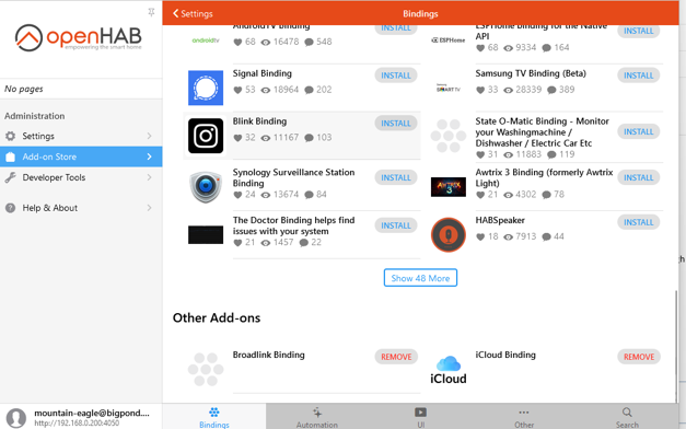

Check Add On Store in GUI for Broadlink Binding is installed if not installed you need to add it.
From what I understand, the Broadlink binding on the add-on store is not required for this binding to work.
