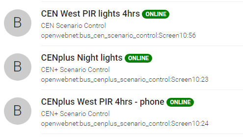

Items file
//CEN
String WestPIRLights4hrs_CEN "CEN West PIR lights 4hrs"  <light> {channel="openwebnet:bus_cen_scenario_control:Screen10:56:button_0" }
//CEN plus. Addresses start with 2 + number 0-2047
String NightLights_CENplus "CENplus Night light"  <light> {channel="openwebnet:bus_cenplus_scenario_control:Screen10:23:button_1" }
String WestPIR4hrs_CENplus "CEN plus West PIR 4hrs - phone"  <light> {channel="openwebnet:bus_cenplus_scenario_control:Screen10:24:button_1" }
Thing file
//CEN
Thing bus_cen_scenario_control 56 "CEN West PIR lights 4hrs" @ "CEN"[ where ="56", buttons ="0" ]
//CEN plus. Addresses start with 2 + 0-2047
Thing bus_cenplus_scenario_control 23 "CENplus Night lights" @ "CEN" [ where ="23", buttons ="1" ]
Thing bus_cenplus_scenario_control 24 "CENplus West PIR 4hrs - phone" @ "CEN" [ where ="24", buttons ="1" ]
