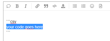

from browers come on the link :http://ip raspberry:9001/ and highlight the code and copy key, in windows CTRL + C
click icon , highlight in red
replace “your code goes here” with your log with paste CTRL + V
