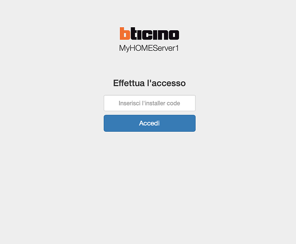

Connected to the Web server is the password check
Hopefully attach the image

the ip is 10.0.1.60 (verified because I can open the server web interface and the mobile app works great)
the password is the one that I use for the mobile app
the port is the default one…how I can understand the port?
what do you mean with “Connected to the Web server is the password check”

Normally the port 20000, but checks in the configuration in the Web server.

On server site I can only download/upload a backup or download the actual devices configuration

I was expecting a different ip 192.168.xx.xx
The IP looks like you are accessing from outside your local network. The default port is 20000. The error message tells you are using a wrong pwd. Did you set the password with the mobile app myHome_up?
