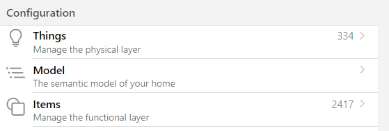

Hi OH3 Team,
I have discovered a bug with OH 3.2m4 with Map Transformation and a large .items file.
This .items file was taken directly from an OH 2.4 working platform and it works natively fine when Map Transformation is NOT installed on OH 3.2m4. Once I install it, I get errors such as this from the REST API (http://openhabian:8080/rest/items).
{"link":"http://openhabian:8080/rest/items/Dimmer_StringLights_State","state":"1002.0","transformedState":"Short Released Butto"{\"error\":{\"message\":\"begin 0, end -1, length 12\",\"http-code\":500,\"exception\":{\"class\":\"java.lang.StringIndexOutOfBoundsException\",\"message\":\"begin 0, end -1, length 12\",\"localized-message\":\"begin 0, end -1, length 12\"}}}"
I’m using the basic MAP syntax that OH 2.x has used → “State [MAP(HUERemote.map):%s]”
This is just one example, if I reload the REST API it will be a different item next time.
Here’s another thread I discuss the same thing, thinking I resolved it BUT it’s tied to Map Transformation Service.
Best, Jay

Considering the code, it could happen in case you missed the extension (.map).
Are you really sure that you use everywhere something like “[MAP(HUERemote.map):%s]” and never [MAP(HUERemote):%s] ?
This is literarily copying the .item and .map files from OH 2.x to OH 3.x.
If I comment out that specific item, it will randomly choose another item that has mapping tied to it. It happens at the end of the REST API call, meaning it works (displays properly) for about 1500+ items then it starts the issue failing.
I believe it could be a memory error on the mapping transition binding OR it could be a timeout issue going across the REST API calling the mapping transition binding.
I wish I could set the timeout value either on the REST API or map transition binding to something higher to rule that out.
Best, Jay
Your exception is clearly when building the path of the transformation file and I believe this exception will be thrown if no extension was provided.
But from this and other examples, it would appear that the actual MAP transform has already taken place but the output text gets cut off and error JSON inserted.
i.e. not a fundamental transform problem, but something like a timeout or messed-up return format.
In the linked thread the unexpected error gets inserted at different points in REST output, not always in transformedState, e.g. in the middle of options
Agreed, as you can see text is getting cut off randomly on the return of the JSON.
I’d be glad to send either @rossko57 or @Lolodomo my item file. It’s just one large file used with OH 2.x for 3 years now.
Best, Jay

Looking like sheer number of Items is the unique factor ??
I have been told to turn OFF zRAM in another thread about RaspberryPi that has 4 GB of RAM.
Here’s my Thing and Item count which are all in 1 file for each.
Best, Jay
