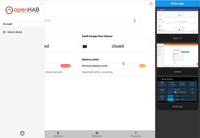

Regular Users
Regular are users who have not logged in or users who have not been configured to be administrators. These users can see all of the interactive parts of the UI (i.e. Pages) and can open other apps (icon at the upper right hand corner of the screen) but they cannot see any of the administration user interfaces nor can they access the administration functions through the REST API.

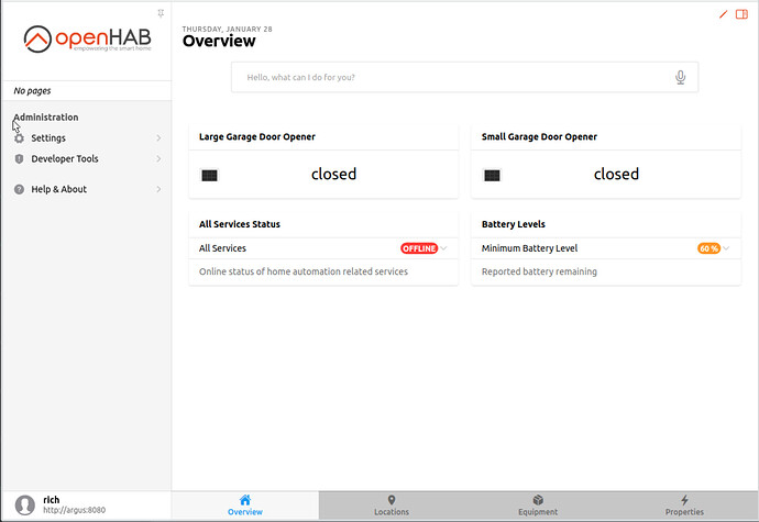

Administration Users
These users have full access to all parts of openHAB. The list of menu options includes Settings, Developer Tools, and the Developer Sidebar. These are most of the parts of openHAB you have been interacting with thus far. Way back in First Steps the first thing you did was create an administration user.

To access the non-“Pages” user interfaces, if it’s installed, it will appear in the menu that pops up to the right when clicking on the small square icon in the upper right corner of MainUI.
