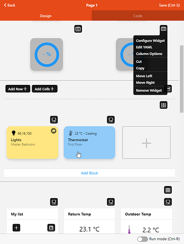

No matter which type of page you’re editing, the designer will feature black buttons beside most widgets, that open a contextual menu for the widget in question:
These menus will in most cases allow you to:

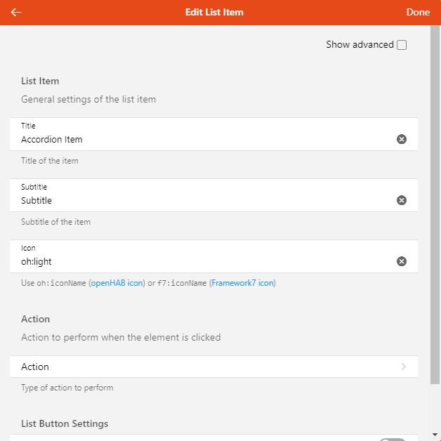

  • configure the documented parameters with a config sheet (“Configure Widget” or similar);
  • open the part of the page’s YAML representation pertaining to the widget (“Edit YAML”), that is, a subgraph of the page’s component tree with that widget as its root component;
  • perform cut/copy/paste operations, if supported (you can only do that in the same page currently, to copy or move widgets between pages, you may use the YAML view);
  • reorder the widget within its parent slot (these options are usually named “Move Up” and “Move Down” although you may occasionally encounter other labels, like “Move Left”/“Move Right”);
  • remove the widget.

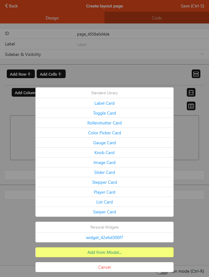

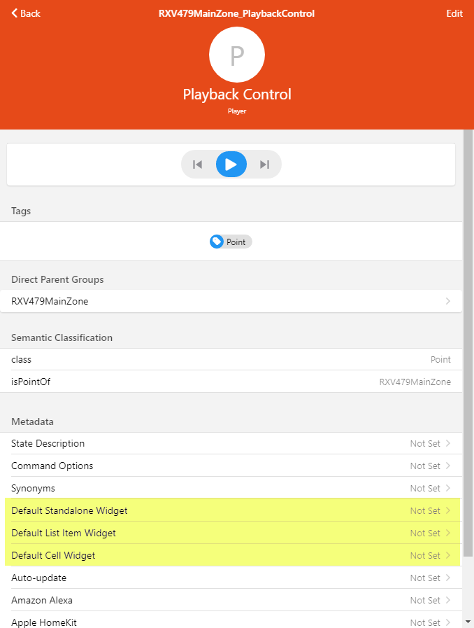

Item Default Widgets
You may have noticed in various parts of the administration pages of the UI that you can operate your items without ever having configured a widget for them: indeed it will try to figure out a “default representation” of this item (either a standalone version, or a list item version, or a cell version), using the item’s type, semantic class & property, state & command description and other means.
You may want to alter this representation though, if the auto-generated one is not optimal or plain wrong; for that, you can use the 3 metadata namespaces widget, listWidget, cellWidget to configure the default representation as you would configure the widget on a page. You can do it for instance from the Model page or the item’s details page:
Then you can either choose another widget type of the same class from the Standard library if you prefer, or use a personal widget (see below). As a general rule, widgets controlling an item feature an item property; when configuring the default representation, you shouldn’t configure this property because it will be automatically replaced with the name of the item being represented. However, you’ll still have to specify other item properties needed by the widget beside the “main” item (for instance for a oh-player-card widget, the album/track items if relevant).
Having this concept of a default representation also helps you add several items at once on a layout page: when asked to choose which widget you want to add, select “Add from Model…”:
You will then be presented with a tree view of your semantic model of items, and be able to choose several of them at once to add to the parent container - depending on the nature of that container, it will add default standalone representations, or list items, or cells. You can then modify them individually locally for the page.
Important: the widgets added to pages from the model will instantiate the default representation at the time of the addition, either the auto-generated one or the overridden one in metadata, but it will not reflect further changes you make to the default representation by modifying the metadata again.
Finally, these default representations are used to show the Items that are part of the model in the automatically generated tabs of the Overview Page. You only need refresh the page to pick up changes on those tabs.

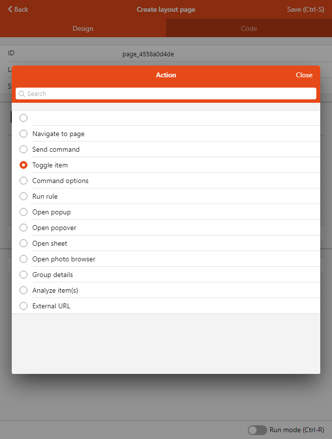

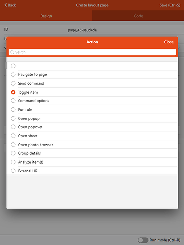

Widget actions

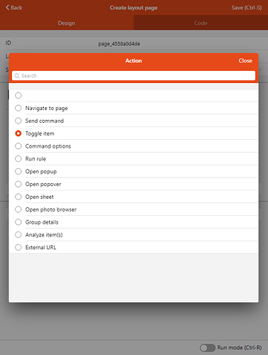

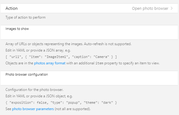

When configuring a widget, you will encounter options related to actions (usually, when something is clicked or touched, but there might be several actions configured for a single widget, for instance, clicking on different parts or a long tap with a touch device); regardless, they will all have the same options:
These action options allow you to configure the interactivity within your pages, as well as the relation between them, in an extensive way. You can navigate to another page, display additional controls, popups and other modals, send commands to items every time a widget allows you to choose an action. For instance, a floor plan marker might either open another page in a popup, or toggle an item.
Configuring the action type reveal more options in the action sheet:
The name of options related to a certain action are all prefixed with the same string (usually action for the default action) to distinguish them from the other options of the widget, or those related to another action.

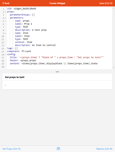

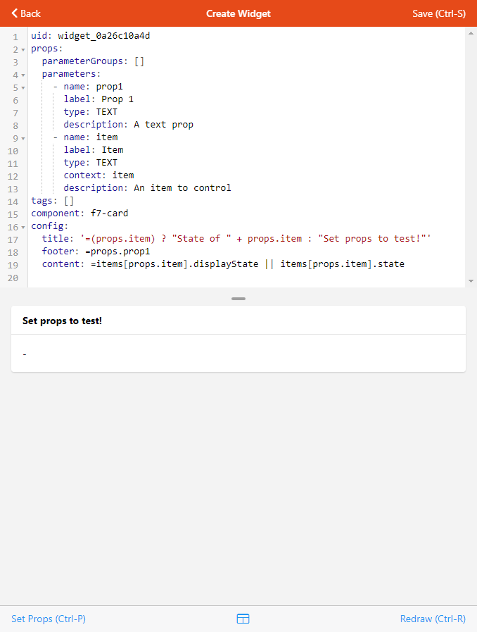

Personal widgets: development & usage
You can extend the library of widgets you have at your disposal by creating personal ones, either by yourself, or copy-pasting from examples by the community; then you can reuse them on pages, multiple times if need be, simply configuring their props to your needs.
To add a new personal widget, as an admin, click on Developer Tools then Widgets. Use the ‘+’ button to create a new one:
The view features a code (YAML) editor and a live preview, you can change the orientation with the button in the center of the bottom toolbar.
Don’t forget to change the uid right away because you won’t be able to alter it afterwards.
Sometimes the live preview will fail to update, you may want to hit the Redraw button or Ctrl-R/Cmd-R regularly when designing your widget.

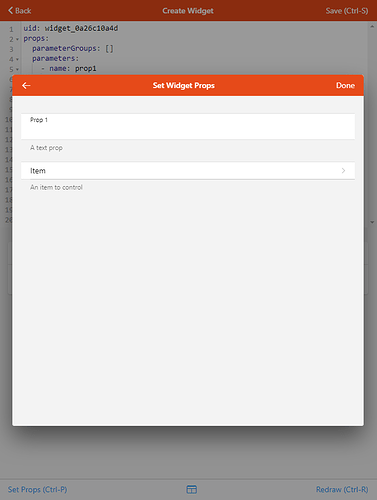

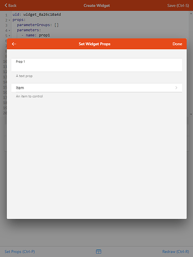

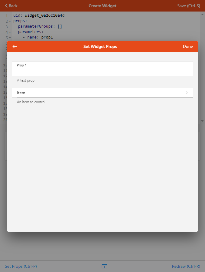

To actually see how the config sheet would look like, and specify props for your widget for the live preview, click on Set props (Ctrl-P) and configure them as needed:
After saving the widget, you will have it as an option (under “Personal widgets”) to add it to a layout page, or display in a modal like a popover, or use it as the default representation of an item.
Note the special widget:<uid> syntax for the component type to specify “use this personal widget here”, the config being the passed as props to the widget:
component: widget:widget_0a26c10a4d
  prop1: Test
  item: Color1

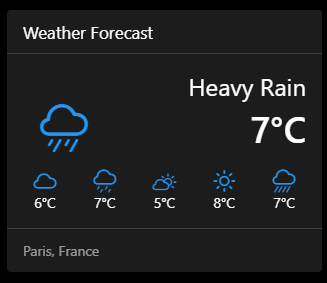

Example of a personal widget:
(exercise for the reader: replace the hard coded values with expressions sourcing data from items using the prefix prop and string concatenation)

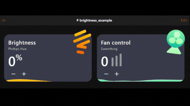

So I just cobbled together at least one widget, that is (with a little effort) reussable for different cases.
It looks like this and supports the most oh-list-components for the bottom row (slider, button, stepper, toggle and more or less icons). It´s working mostly correct on all devices I tested it with (web, ios, android)
2020-09-22 00-02-09
brightness_variants
Further more I already roughly cleaned up the color-changing widget of this ‘theme’, which looks something like:
color_example
All of the color and icon ideas came from a dribble UI concept I found via google from Amogh Srivastava (thx! https://dribbble.com/shots/11450842-Smart-Home-UI-Concept#shot-description)
You can find the first itteration of the brightness example from above on a github repo - rebuild it, extend it, use it, do whatever you like: GitHub - rgrollfitz/oh3-widgets
Disclaimer: I only have basic experience in working with css and none with the infinite nested yaml-structure. So please keep this in mind while watching the repo. :slight_smile:
Having some more conecept ideas lying around here and will finish and post them in this forum, as soon as I find time.

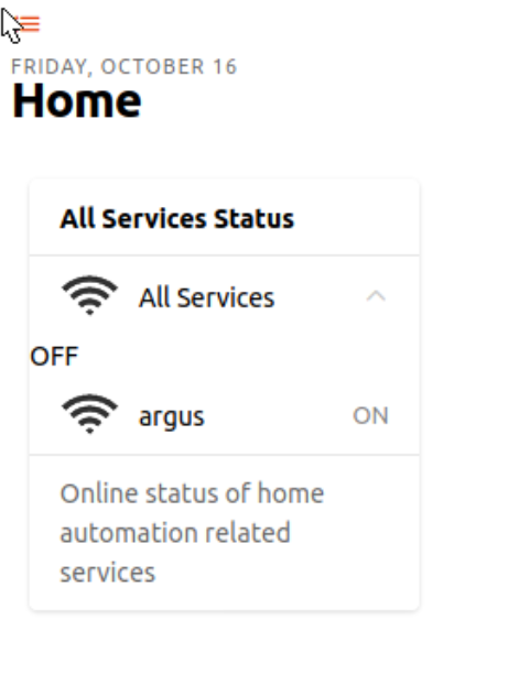

Can someone smarter than me post an example of a collapsible list? I’ve spent too much time on this already. It seems like the following should work:
component: oh-list-card
  accordionList: true
  title: All Services Status
  footer: Online status of home automation related services
  default:
    - component: oh-label-item
        item: ServiceStatuses
        title: All Services
        subtitle: When OFF one or more services are offline
        icon: oh:network
        accordion:
              item: vArgus_Status
              title: argus
              subtitle: Home automation server
              icon: oh:network
              accordion:
                    item: vInfluxDB_Status
                    title: InfluxDB
                    subtitle: Home auotmation database server
                    icon: oh:network
              item: vCerberos_Status
              title: cerberos
              subtitle: Garage sensors and actuators
              icon: oh:network
              item: vFafnir_Status
              title: fafnir
              subtitle: NAS server
              icon: oh:network
Thanks!
But when I try the above all I see is
I’m clearly doing something wrong for the subsequent list Items after “argus” but I can’t see what that would be.
I an just guessing. Is there a slot and accordion to much after argus??
My intent was to have argus also be an accordion that opens up. So I’d have three levels, like:
All Service
    argus
        InfluxDB
    cerberos
    fafnir
Based on the examples I assumed this was how to do it but I guess it’s not and I’m stumped.
Can’t do it either :cry:

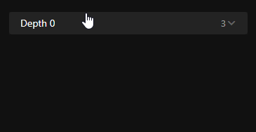

I was able to do one level of depth like this, but no further:
  accordionList: true
  default:
    - component: oh-list-item
        accordionItem: true
        title: Depth 0
        after: =1+2
        accordion:
              default:
                    title: Depth 1 - Item 1
                    after: =2+3
                    title: Depth 1 - Item 2
                    after: =3+4
                    title: Depth 1 - Item 3
                    after: =4+5
2020-10-17_00-45-06

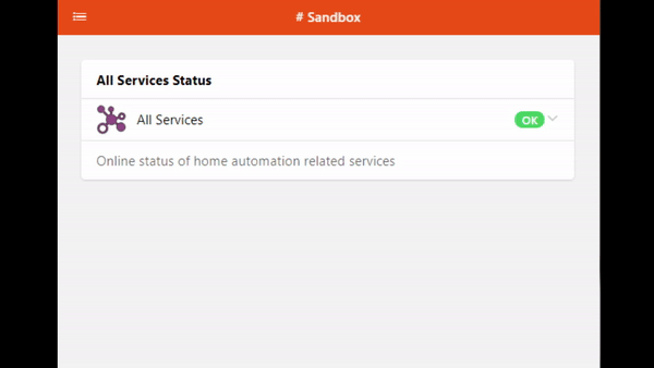

I got it working with a few limitations and some nesting :crazy_face:
  • Nested ‘icon: xy’ would work but will mess up the accordion layout a bit
// EDIT
  • I added some real items for testing now and it seems, that the ‘item’ parameter isn´t present in ‘oh-list-item’ so you have to trick around this with an expression like ‘after: =items.vArgus_Status.state’, which should also work for the badge, if you like it.
//Edit2:
  • Contrary to my statement that ‘subtitle:’ won´t work in ‘oh-label-item’ - its just depending on the ‘mediaList: true’ parameter - if set, everything works fine. :wink:
nestedAccordion
uid: nestedAccordion
tags:
  - nested
  - accordion
  - list
  accordionList: true
  default:
        title: All Services
        icon: oh:network_purple
        badge: " OK "
        badgeColor: green
        accordion:
          - component: oh-list-card
              accordionList: true
              noBorder: true
              noShadow: true
              outline: true
              default:
                    title: "argus"
                    accordionList: true
                    noBorder: true
                    noShadow: true
                    outline: true
                    accordion:
                          title: "influxDB"
                    title: "cerberos"
                    title: "fafnir"
                    title: Show analysis
                    listButton: true
                    action: analyzer
                    #actionAnalyzerCoordSystem:
                    #actionAnalyzerItems:
