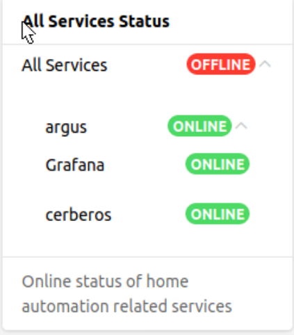

Is there an expression I can use to make the badge color depend on the state of the Item? I experimented with trying a trinary operator and the like but the editor marks it as wrong no matter what I try (probably means the answer is can’t do it). Maybe I have to use visibility?
Ultimately what I’m shooting for is a three layered accordion list that rolls up the status into one line. If something goes offline I can open up the list and see all my machines and identify which machine has something offline. Clicking on that shows the list of services and I want to see which one is offline.
So, for example, if InfluxDB goes offline All Services will show as OFFLINE. Opening that and Argus will show as OFFLINE. Opening that in turn will show that InfluxDB is OFFLINE and everything else is ONLINE.
Maybe all I can use is the after and not the badge? But being able to show the state with a colored badge would be really useful.

OK, I got the badge stuff working. I can’t seem to get at the state of the actual Items though.
But I’m trying to get your collapsible list to work above and it does indeed work if the third level only has one Item (InfluxDB in that example). But if there is more than one, only the first one is shown.
I’ve tried:
  • using oh-list-items instead of oh-label-items
  • making the each second layer component be an oh-list-card too
  • playing with using default and accordion under slots.
The closest I’ve come to success is as follows:

Am I doing something stupid? Are two levels as deep as one can go? Obviously I have other approaches to display this information if it simply can’t be done, but I think a collapsible list like this is an elegant solution if I can get it to work.
Thanks for all the help so far!
You don’t really need oh-list-card inside an accordion slot, a oh-list is enough (with accordionList: true if there are accordion items in it) but it is necessary - you can place anything in the accordion slot - i.e. and collapsible area - so you need to organize it like this:

So, at every level:
  1. you should have a oh-list (or oh-list-card at the root level) with a collection of oh-list-item in the default block.
  2. To make a collapsible item, the oh-list-item in question should have a accordion slot, which should contain a new oh-list like in 1.
  3. Every oh-list having accordion (collapsible) items should have accordionList: true in its config.
Here’s a working version (without the badge properties for clarity). Note the class: - margin-left to give increasing margins to the lists to make them look like a tree view:

Fantastic! That works! I’m thinking we may need to come up with a pretty good reference and maybe some tutorials for some of the more common widgets users might want to make. I think I’m starting to understand this part of it at least. Thanks!
