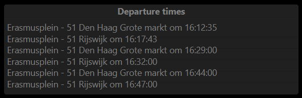

The use case, instead of using an app/ website to search, just display all departing busses on a stop on my (wall mounted) dashboard. Lets start with the end result so you know time spent on reading is worthwhile. A tile (for a dashboard) with bus departures with the name of the stop, the bus number, destination and time.

Next challenge it to display it on my wall mounted dashboard in a nice list. I created a widget for it using the oh-repeater . This can split text in parts and use that parts in a repeating component. Biggest challenge (for me) was getting rid of all the whitespace that makes it to big to display in the tiles I uses. And getting the colors in my theme. So there’s some CSS configuration to take care of this. Probably my knowledge of openHAB but the widgets ignores some of the styles (CSS+f7-styles) that are already on the page as well.

Most interesteting part is a trick to limit the amount list items to six by using the index of the repeater and the visible property.
visible: =loop.bus_idx<6
Most stupid part is this piped replaceAll. But I read on the forum regexp’s aren’t allowed in widgets.
loop.bus.replaceAll('"','').replaceAll('[','').replaceAll(']','')
To use it, copy the above code in a new widget. It had only one property, the item you made for the departure times. Now you can use this widget on your pages.
