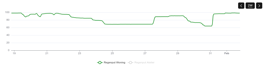

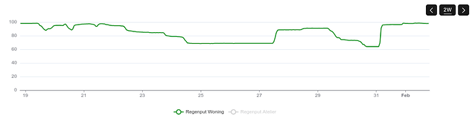

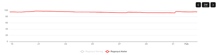

Guess that I’ll have an issue, since for example an average toilet use is 3 ~ 8 liter. And with a tank of 10.000 liter, this is very small. In my graphs, you see it going down over a longer period, but an average flush fe isn’t noticeable in the logs. At least not at first sight.
One of the advantages you get by calculating the delta from the last time you processed the change is that it doesn’t matter how long it takes for the value to fall below the threshold.
However, this raises a concern because there will be lots of situations where usage will be missed. What if you run the washing machine while it’s raining? The level might be going up faster than it drops from usage. What if it dropped just a little, not enough to trigger the rule and then it rains?
The calculation will only ever be a rough estimate. To get closer you need to measure the water actually coming out of the pipe, not the tank level, as @rossko57 said.
But the only problem I see with that first graph is that it increases the likelihood that you’ll miss some usages. But I don’t know that taking more frequent readings will help much.The problem is the precision of the measurement, not the time between measurements. If you can’t see a toilet flush in the data, taking more frequent readings isn’t going to fix that.
Here in Belgium, they’re rolling out smart energy meters. The ‘goverment’ want us to spread our consumption. Use power when there’s sun! So in the future, we shouldn’t wash when it’s rain.
But I see your point.

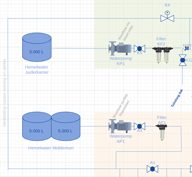

I’ve got a “FIBARO Switch 2” on the power line of the rainwater pumps. The pumps are very basic.
Main reason is that I can power on/off the pumps in function of the water level, and the function.
One installation is mainly for garden/toilets/…, other installation (better filters) is mainly for washing machine. But both can be disabled/enabled, based on the levels of tanks.
Level of tanks is measured with pressure sensor (ALS-MPM-2F) and KNX input module ( MDT AIO-0210V.01).
This or put some sort of meter on the actual water flow will probably be your most reliable ways to measure consumption. Anything else will be no better than a rough estimate, which may be good enough.
Using the flow of the pumps comes with its own wrinkle. Does the flow vary based on the water level in the tanks?
