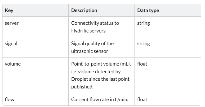

The device sends a few data items. I think we’re mainly interested in Flow and Volume.
Here’s what they look like in the event log.

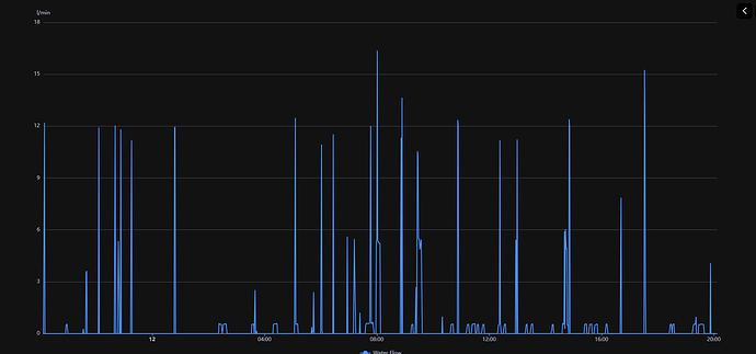

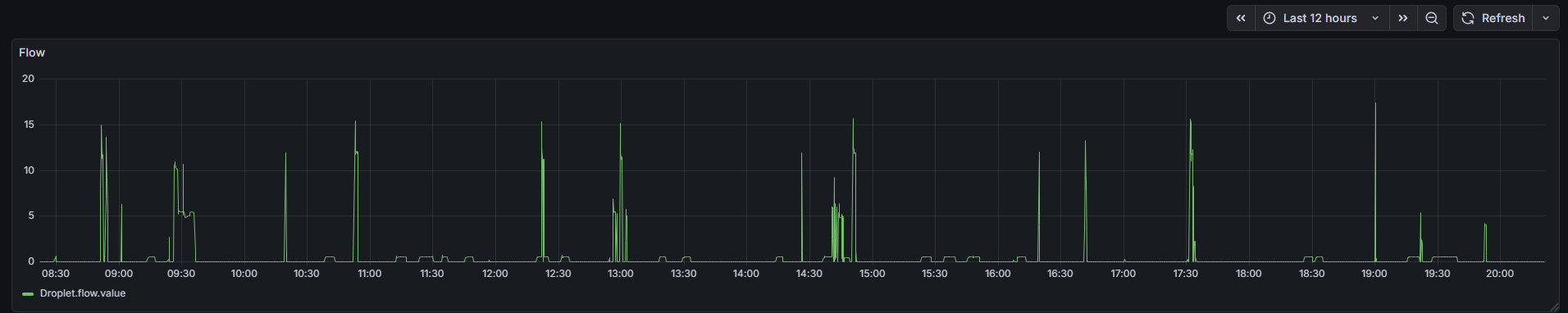

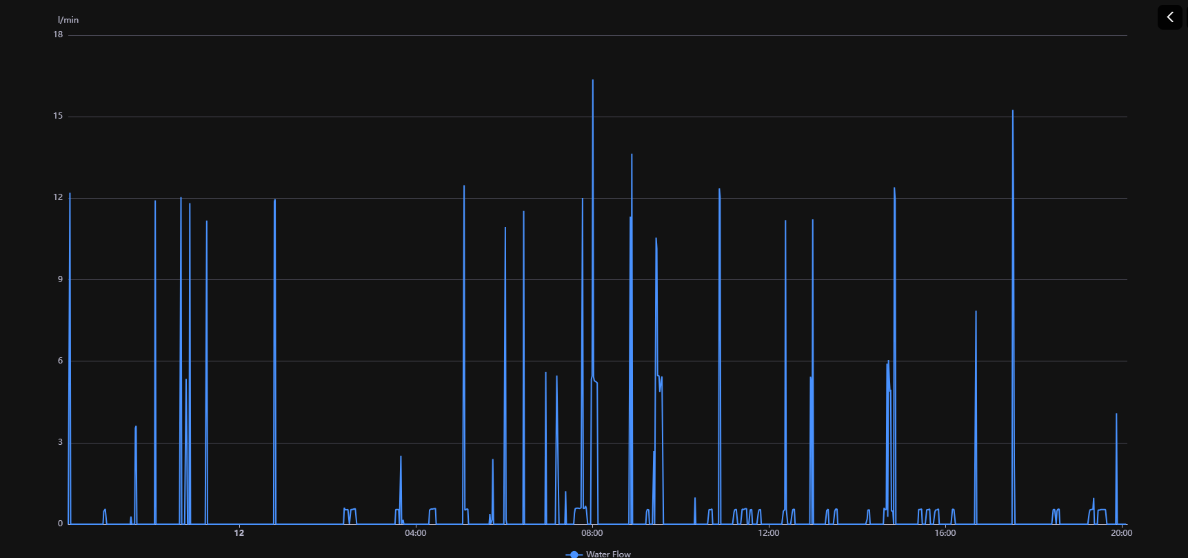

I do have RRD4J MapDB and Influx set up to persist on every change.
Here is the chart for Flow
And here’s what the flow data looks like in Grafana
