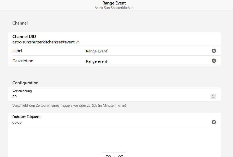

You can do this without any rules via offsets on the range channel (if you need a channel trigger, or also on other channels for displaying purposes):
If you need both times, create two separate Astro Things.

Thing   astro:sun:offset            "Sonne Offset"          [ geolocation="47.4060200, 9.6085110,404", interval=300 ]
    Channels:
        Type rangeEvent : set#event
            offset=-60

If I am not mistaken, you did not define the event the offset should be added to.
It should be set#end, not set#event in your .things file.
