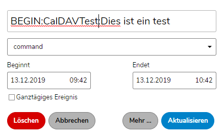

Commands from the “command” calendar are also properly detected however the execution fails see log file. It cant find the calendarId what seems a bit strange for me since it can fetch the data and put it into a cron job. Whats wrong?
The calendar entry loks like this: “BEGIN:CalDAVTest:Dies ist ein test”

thx but no that was not the problem.
Solved it now myself:
I put the “BEGIN:CalDAVTest:Dies ist ein test” in the wrong place. I did put it into the tile but it needs to go into the description of the event!
