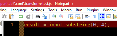

one line in js:
input = input.substring(0, 4);
Try this return = input.substring(0, 4);
