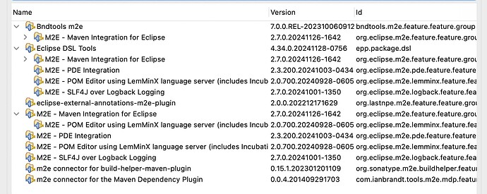

It works without problems in my setup. I can’t test the binding because I don’t have any shelly devices, but the binding shows up, I can add devices manually, and in general: there’s nothing that indicates any problem.
I’m running:
  • Eclipse 20241128-0757.
  • Bndtools 7.0.0.REL-202310060912-gb82dc86
  • M2E 2.7.0.20241126-1642
