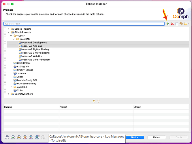

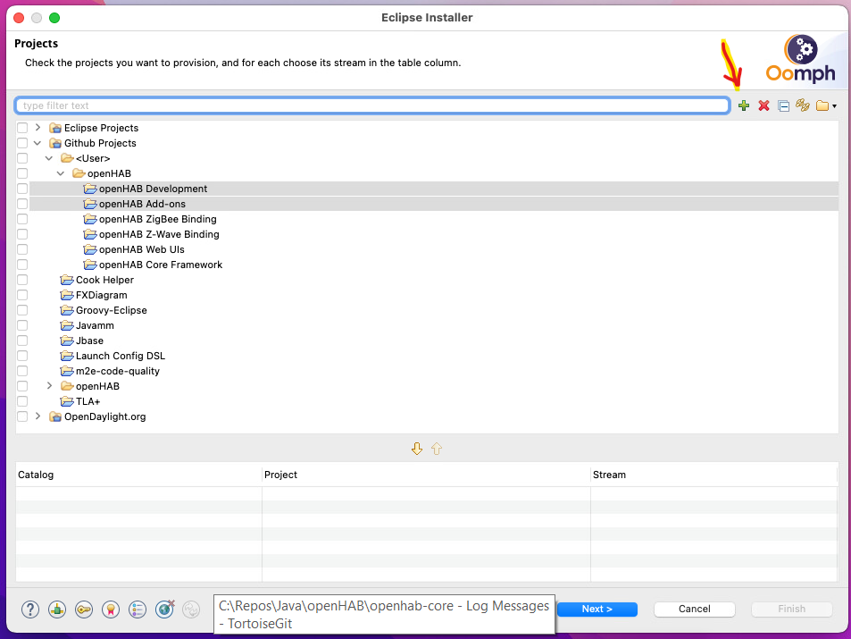

After having saved the file somewhere, you start the Eclipse Installer as usual, select “Eclipse IDE for Java developers”, Next and then when you get here:
..you click the little + button that I’ve tried to point out, which leads to this dialog:
Select “Github Projects” under “Catalog” (it won’t work without something there), and either Browse File System or enter/paste the full URL to the .setup file. After clicking OK, you will have a new openHAB project under <User>, and this is the tweaked .setup file. Select and continue as usual from there.
