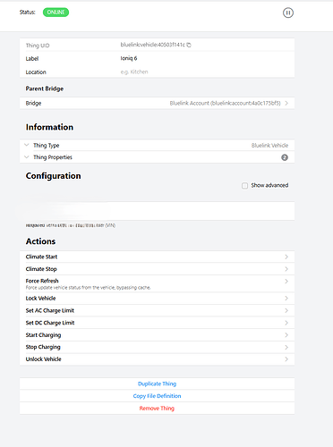

I have a bluelink Car connected to my openhab and would like to start the heating/ cooling from a blockly rule.
The Car only accepts thing actions to do that. When calling the actions directly from the thing page everything works. How can I integrate this action into a switch in the UI?

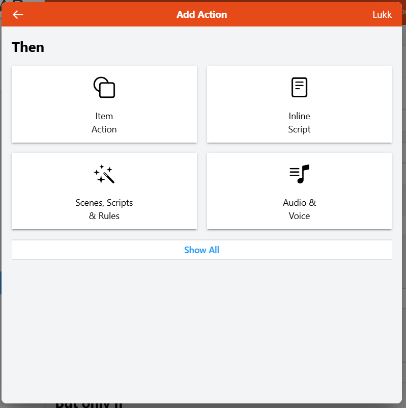

You don’t need to write a script to run a Thing action at all. Just add an action to the rule, and click “Show All”:

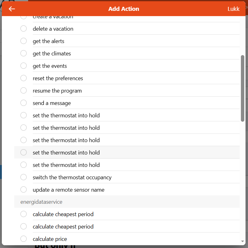

This will display a list of all available actions, including those provided by Things:
Just pick the action you want the rule to use, fill in the parameters, and save.

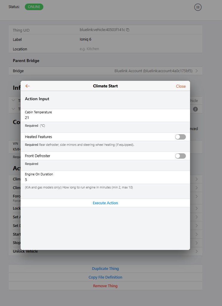

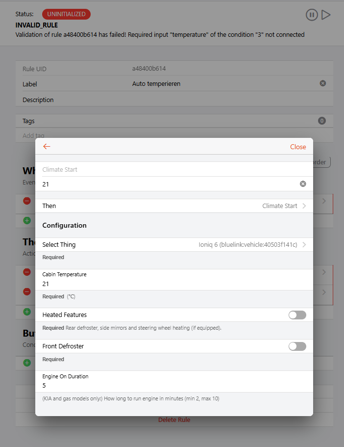

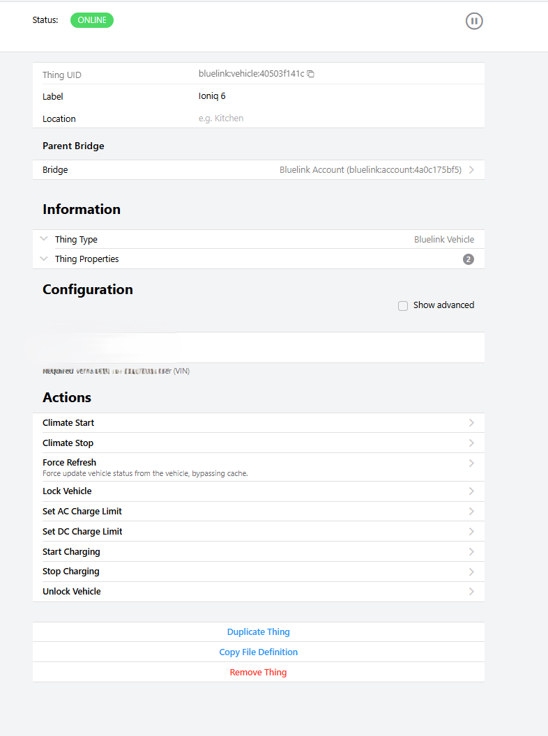

Thank you. That was the solution I was looking for. However due to some reason unknown to me I get an error message when I add the action.
If I execute the same action directly from the thing it works. Can someone help me or could this be a problem with the binding?
Problem when calling the action from a rule
Calling the action directly from the thing works with the same parameters
