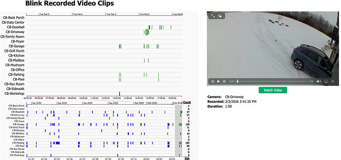

  4. Created a servlet-web page (running in the OH JVM) which allows the user to visually see all video files stored by the retail Blink cloud, on a timeline view, with a separate swim lane for each camera. There is a small timeline at the bottom showing every video stored by the cloud (they limit it to 500 videos or 60 days unless you pay for a subscription), and a larger timeline above that, showing a zoomed-in view. The user can zoom in and out and pan the zoom window forward and backward in time to see historical recordings. Hovering on a video clip shows the thumbnail, and clicking on it allows the user to play the video in this web page using the browser’s built-in video playback controls. Here is a screenshot showing a video being played back. The selected video is an animated (pulsating) rectangle on the “CB-Driveway” swim lane.
This is a work in progress, missing a legend (blue is viewed, green is new), and proper memory management (I’m caching too much stuff without limit), and keyboard navigation, so it’s not really ready for prime time. But I wanted to put this out there in case:
