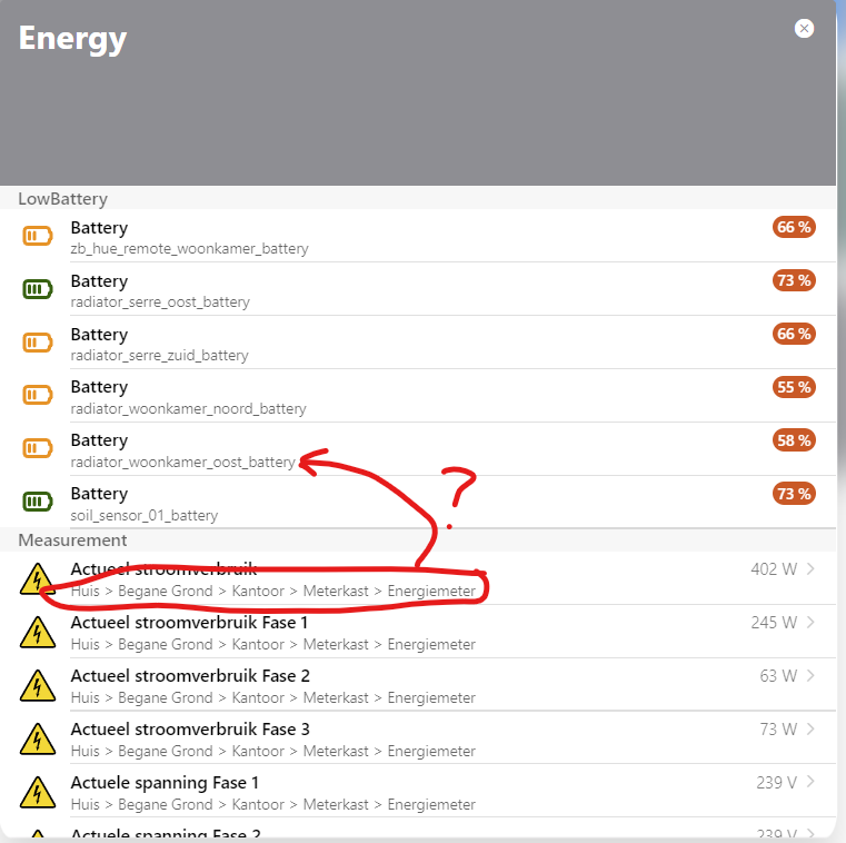

Can I get the 'Item Context Label' show up in my custom widget?
I’m trying to develop a custom list widget. So far so good, the new widget shows up in tabs of the Home Page (ie. Locations/Equipment/Properties Tabs). I would like to have the Item Context Label that shows up in the default widgets in my custom widget. Is this information available for custom developed widgets to reference in a slot?
