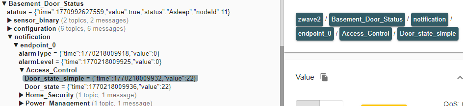

The other thing that is not clear from your post (to me anyway). There is a MQTT thing connected to the broker, but you also have to manually create a generic MQTT thing (unless your device uses a discovery protocol like HA). The channels then have to created. I use MQTT explorer to copy/paste. Example

For the first channel from MQTT explorer

After running the MQTT Explorer locally via `docker run --rm -p 3000:3000 -e MQTT_EXPLORER_USERNAME=admin -e MQTT_EXPLORER_PASSWORD=your_secure_password Package mqtt-explorer · GitHub` and connecting to my MQTT broker, I could successfully see all the Valetudo topics and create the associated Generic MQTT Thing and related channels in openHAB.
