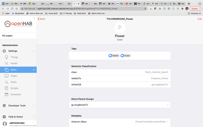

I’m trying to create an OpenHAB group to control a television… I have 2 items within the group as follows…
A switch item to control power that is configured as PowerController.powerState

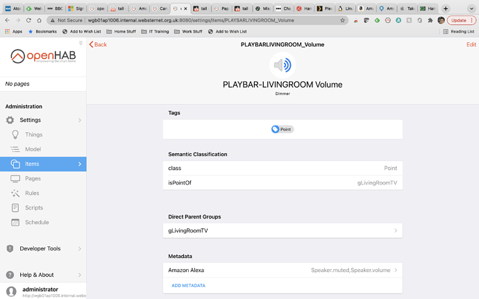

A dimmer item to control volume that is configured as Speaker.volume

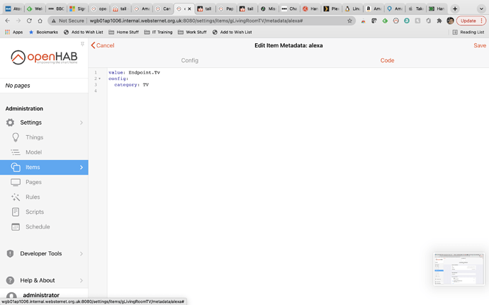

However, if I then tag the group that both items are members of as Endpoint.Tv then neither item is discovered. I understand from the documentation that this is correct and the group should then be discovered as a single item within the alexa app that I can control the different members with voice commands but the group is never discovered. The group is labelled “Living Room Television” and so I was expecting to be able to use voice commands such as “alexa, turn the living room television on” or “alexa, turn the living room televison down”.

Your configuration looks good to me. Just some minor observations, the category parameter don’t need to be specified since it is derived from group endpoint type. Also, the speaker.muted capability is ignored since it is not supported on Dimmer item type.
Keep in mind, you need to remove the previously discovered single endpoint items as they don’t get automatically deleted on the Alexa side. So I would recommend deleting your existing devices and then triggering a discovery.
I’ve tried numerous times to discover the group item, each time removing the single items on the Alexa side without anything being discovered. If I remove the Alexa config from the group, the individual items are discovered every time… Remove them on the Alexa side, re-add the Alexa config to the group and nothing is discovered. Remove the Alexa config from the group and the single items are discovered again.
Bingo… Checked the group and found there was Alexa metadata configured there… No idea how/why I configured that group as Endpoint.Other but I removed the Alexa config from there and I can now discover the Televison group!!!
