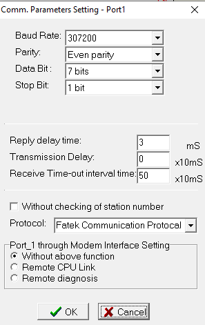

Hi, You have FBs-CBES right? I WinProloader configure port 1

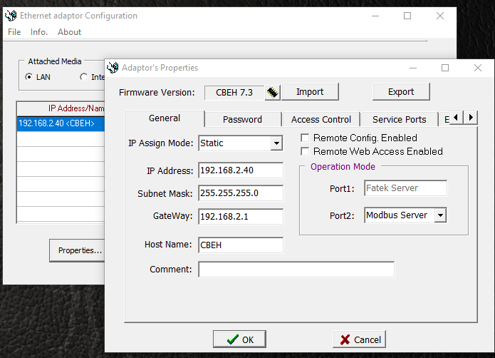

And CBES in Ethernet adaptor Configuration

Hi, have you configured Fatek and CBES as I wrote?

Hi , sorry for the delay. Yes my settings are same as per your guidance. Im using CBES Module for information.
