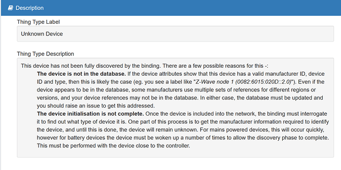

Cannot resolve to a ThingType for Minoston Z-Wave Plus Smart Dimmer Toggle Switch (MS13Z)
First this is my configuration:
The log says:
Device discovery could not resolve to a thingType! 0312:FF00:FF02::2.3
I checked the z-wave database, it’s there
https://opensmarthouse.org/zwavedatabase/1229
This has been for a few days.
It looks like it’ should be in the database. Can anybody help me to diagnose why it’s not initialized completely?
Thanks,
Mao

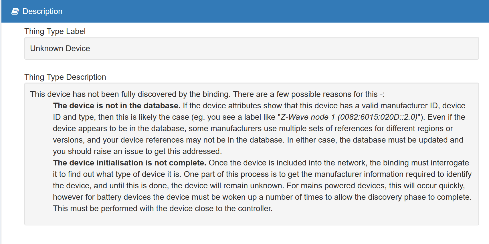

I didn’t make it work to put the file to addons folder. So I upgraded to 2.5.12 latest snapshot. But the device is still shown as unknown device.
Your device is in the database but has not made it into the binding yet:
Please wait for one of the next available snapshots.
