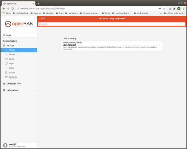

Clicking on the blue + button

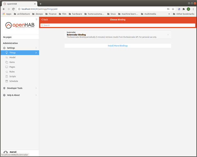

(Picture)
Clicking on buienradar

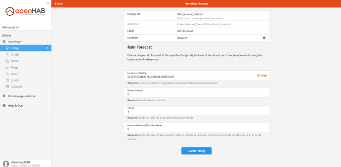

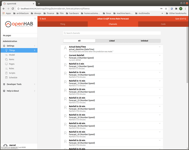

(Picture)

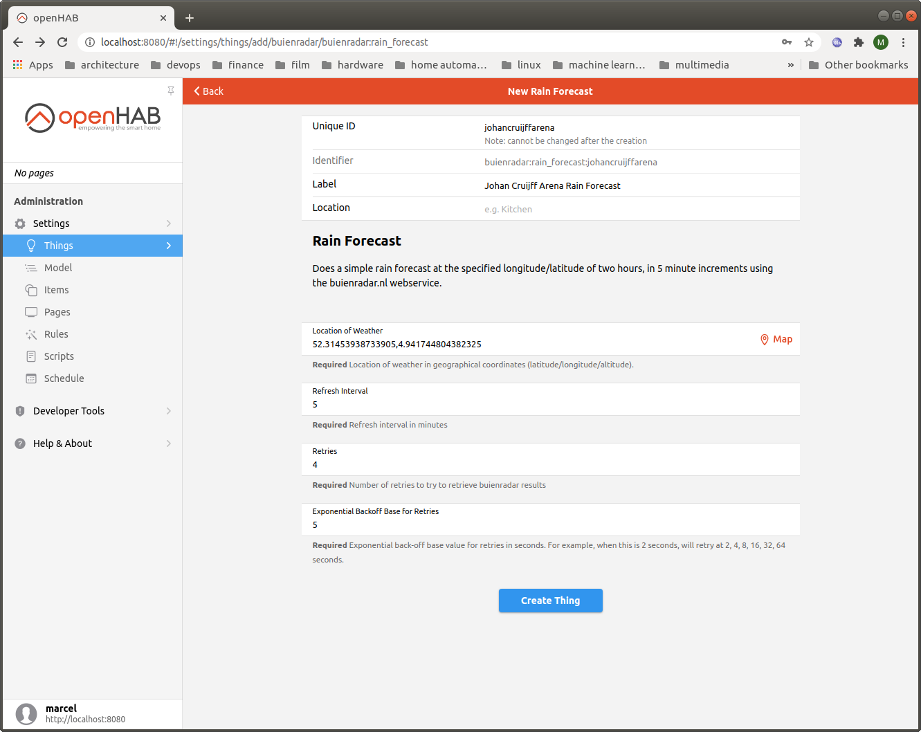

Clicking on rain forecast
Added a random location and changed the unique ID and location, then clicked on Create Thing
(Picture) (Could only download one screenshot because I’m a new user)
Automatically returned to the things page, and the buienradar thing is not here.
