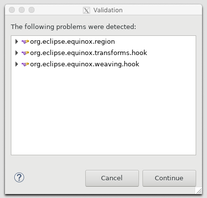

Now everything compiles ok, but running the openHAB_runtime configuration gives the following problems during validation. Anyway if I continue, the systems starts, but there are no UIs available. How can I get paperUI included? Isn’t it part of the core? Thanks a lot.
There’s an issue for this:
The problem with validation is now gone.
