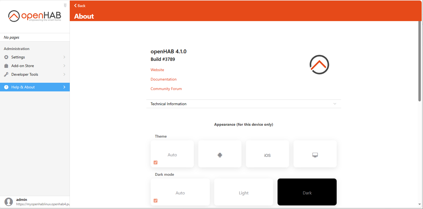

from your web interface can you click on help and about and see what version it shows there?
like this.
Most likely GUI? (openhabian?) is saying you are on the latest and that is correct.
I must admit I am not familiar with an option in the GUI that offers way to upgrade so I will have to assume you are referring to Openhabian which I do not use.
If you are on 4.0.4 that is in fact the latest stable version.
All of the 4.1 versions are milestone or snapshot versions so you would have to change option or configuration files to select one of those versions.
