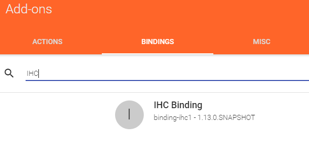

When i search for “Neato” in Add-ons in PaperUI, i can’t find anything. Therefor i tried to copy the .jar file i found to /usr/share/openhab2/addons.
I did that with the IHC controller .jar file, and it showed up in PaperUI.

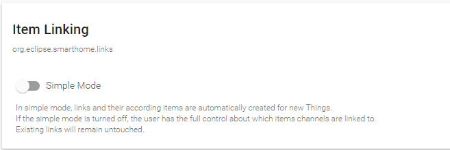

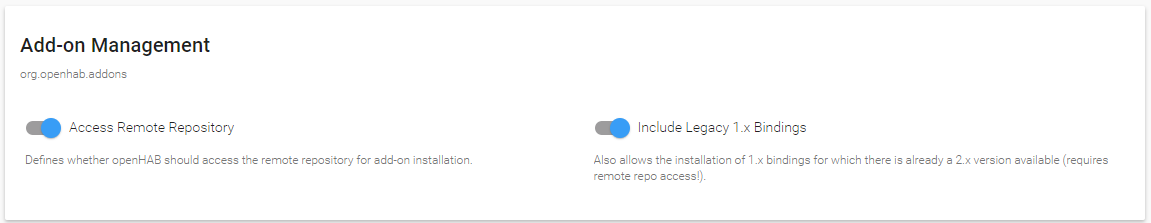

Do you have Simple Mode disabled? Do you have Show Legacy Bindings enabled?
