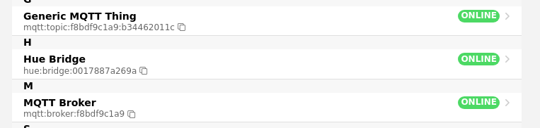

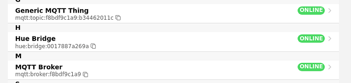

The problem I’m having is how to get that out into my sitemap. I started by following the tutorial and I created the MQTT Broker. Then I created a Generic MQTT Thing based on the broker:

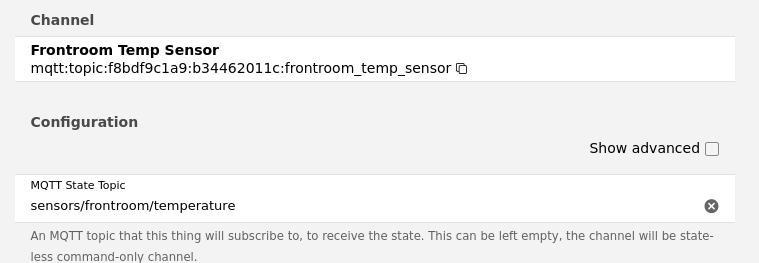

Then in the generic MQTT Think I created a channel for the topic:

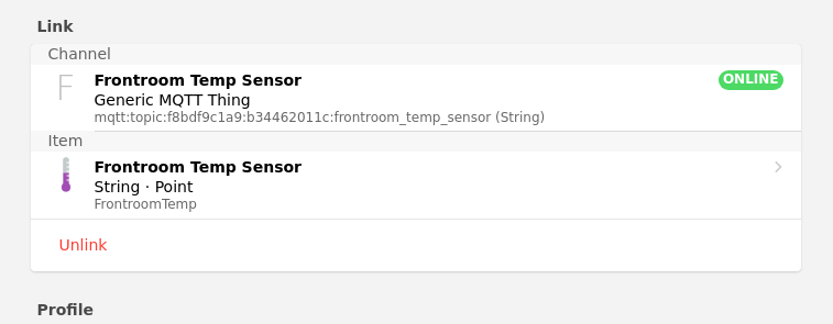

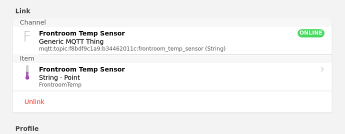

and lastly I created the point item that is linked to that channel.

2022-03-31 20:19:12.658 [WARN ] [ui.internal.items.ItemUIRegistryImpl] - Exception while formatting value '' of item FrontroomTemp with format '%.1f °F': f != java.lang.String
I’m not exactly sure what I am doing wrong here. For some reason it seems to be getting a null or zero length string from the topic.
Do it with type Number
Sorry, do what with type Number where?
The sitemap entry that I have is directly out of the demo documentation.
*edit: I see what you mean. Change the item type to Number. Ok let me tweak that and see.
exactly. I have it as Number defined (item and channel).
