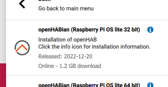

I used the Raspberry PI imager (v1.7.3) to pull the image and burn the SD card

Looks like it’s a problem with the Pi imager openhab distro.
I downloaded a fresh image (openhabian-pi-raspios32-202212201337-gitb2e396e-crc9e18ad69.img.xz) and burned a new SD card (the old way) using Etcher … no problems sudoing as openhabian
