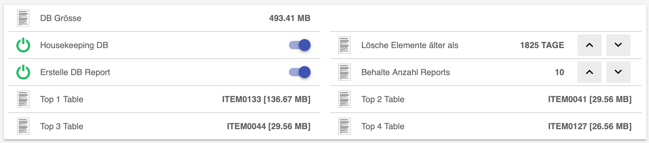

I want to share my solution for persistence DB cleanup and report generation.
You can configure the defaults in “dbTools.conf”.
And you can change some of the configuration values via BasicUI (If you create the items and sitemap).
If there are no items, the defaults from the file “dbTools.conf” will be used.
You also need “jq - Command-line JSON processor” installed on your server.
→ yum install jq
I execute the script daily via crontab rule.
At least one entry remains in the DB, also if it is older than the defined cleanup value.
Tested on CentOS 7.7

/etc/openhab2/sitemap/dbTools.sitemap
sitemap dbTools label="dbTools" {
	Frame label="Systeminfo" {
    	Text item=dbToolsSize label="Grösse DB" {
        	Default	  item=dbToolsSize
			Text	  item=EmptyValue
			Switch	  item=dbCleanupSwitch
			Setpoint  item=dbCleanupRetention minValue=1 maxValue=5000 step=1
			Switch	  item=dbReportSwitch
			Setpoint  item=dbReportNumber minValue=1 maxValue=1000 step=1
        	Default	  item=dbReportTop1
        	Default   item=dbReportTop2
        	Default   item=dbReportTop3
        	Default   item=dbReportTop4
