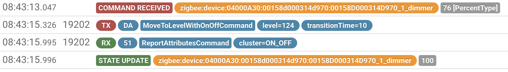

Cephei ZigBee Switch
I am trying to get a Paulmann Cephei Switch to work. I managed to pair it as a generic ZigBee Device with this xml:

Just as an addon: I also tried the Paulmann Cephei Dimmer (00158D000314D970) today (with the same server version as above), and it seems to have the same problem as the Paulmann Cephei Switch:

The actual events where I changed levels in PaperUI Control Panel happened in the last 500 lines (“tail -n 500 openhab.log > tmp.log”), eg:
20:59:55.<small>461</small> 19202 [<small>TX 33 MoveToLevelWithOnOffCommand **level** =71 **transitionTime** =10</small>](https://www.cd-jackson.com/index.php/openhab/zigbee-log-viewer#info-67)

It’s strange - I can’t see anything wrong with what the binding is sending. It never seems to send an ON command, and in all cases the device just reports it is at 100% -:
This is just one example, but there are quite a few in the log.
I do see a few strange things that look like there could be some sort of delay in the messages being sent, but putting that asside, the binding seems to send a lot of OFF, or LEVEL commands - never an ON or LEVEL(100) command, and yet the device keeps saying it is on.
