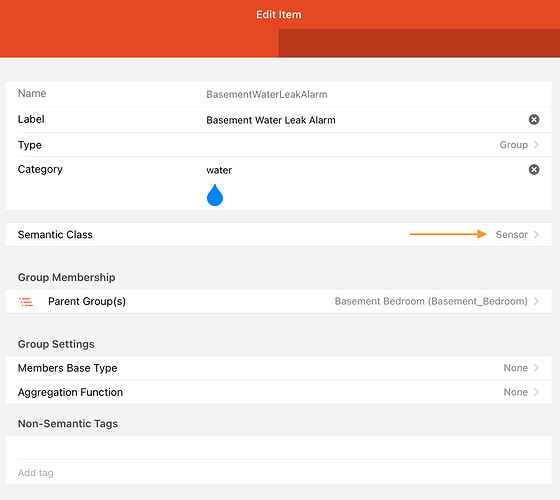

When you “add equipment to model” you have the option to set the Equipment tag to what ever you want.
After the fact you can change the tag from the model:
or from the Item page
