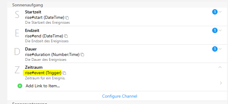

The thing "sun" offers me following channels:
When I try to link an item to the sunrise event i got errors:

yes, it is.
First of all try to link an item by MainUI. You will see that your item needs to be of type „string“ and you need to provide a profile (Trigger Event String).

Event Channels are not really supposed to be linked to Items. Event Channels represent momentary occurrences, not a persistence state.
Each solar event has four Channels, the start Channel, the end Channel, duration Channel, and the Event Channel. Why do you need to store the sunrise event in an Item? Once the rise event occurs, it’s pretty much meaningless thereafter.
This strongly smells of an XY Problem. There is almost certain a more appropriate approach to achieve your overall goal.
If you need to trigger a rule when sunrise starts or ends, use the event Channel to trigger that rule directly. No Item required.
If you need to know when sunrise started or ended or if you are between the start and end, link the start and end Channels to DateTime Items and compare now with the states of those Items. If you want to know how long sunrise takes, you don’t even need to do the math yourself, just use the duration Channel.
I can’t think of a single use case where you would need to put “START” and “END” into a String Item to achieve anything you’d need to do with a sunrise event.
That’s the part that makes this smell like an XY Problem. You can already get the date time from the start and end Channels. You can trigger a rule directly from the event Channel, no Item involved. So what’s the use of linking the Event Channel to an Item? It doesn’t provide anything that isn’t already available.

What you write accurately describes my assumptions. I think the error comes from ASTRO items from OH1.8. I’m still in the process of migrating all the old stuff to the new thing/item concept.
I have incorrectly transferred old “ITEMS” into the new concept…
That makes some sense. In 1.8 and early 2.x versions, there wasn’t such a thing as an event Channel. So Astro “faked” it by toggling an Item when the event occurred then toggled it immediately off.
Since the creation of event Channels, such momentary events which do not carry a persistent state are supposed to be represented through these new Channel types which can directly trigger a rule instead of needing to go through an Item.
Other cases where you might see event Channels are button presses, motion detection (though a lot of bindings still use state Channels for this unfortunately), etc. In general, any time where once the event has occurred there isn’t a meaningful state to keep track of an event Channel should be used. (Note, this is why I said above that @Oliver2’s use case points to a bad design since the time of the alarm is a state that should be stored in an Item).
Another thing to note is that you can trigger a rule based on the state of a DateTime Item. So in the case of Astro you could use the DateTime Item for sunrise start as the trigger to the rule and the rule will trigger at that time. So theoretically Astro could eliminate the event Channels entirely. But I don’t see that happening because it would be quite disruptive out of proportion to the benefits.
