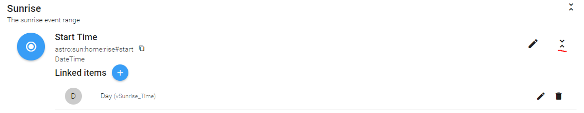

The problem: I’ve got a problem within paper ui- items-channel.
The channels do not appear in the items, when i click on the item. Nor can i change the by clicking on the pencil icon, and i can’t trow it away with garbage can icon. Nothing will trigger those icons.

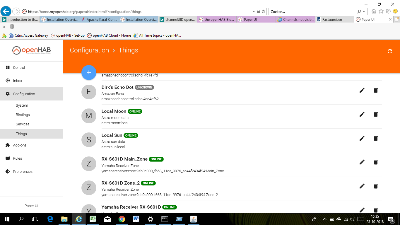

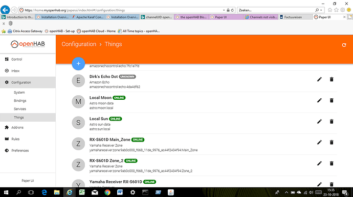

When i add, in the map add-ons, binding astro or any other binding, it goes to mine Inbox.
When i click on the binding in ‘the inbox’ it will appear in the Things folder under map configurations. (it will take a time, and sometimes i’ll have to refresh the site). And then i can’t do anything with those Things.

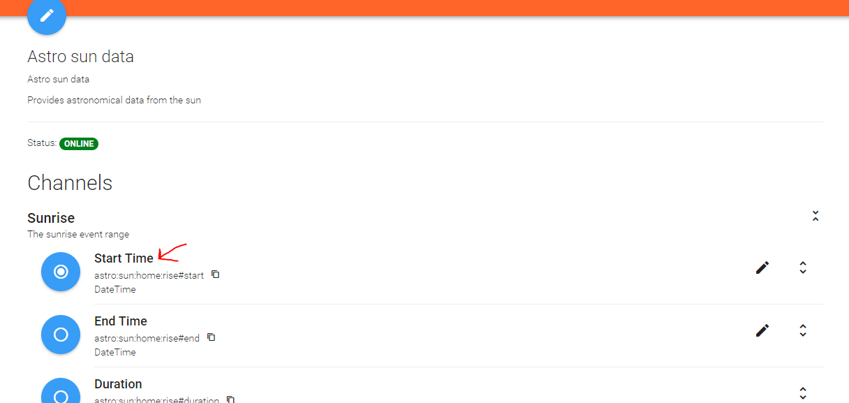

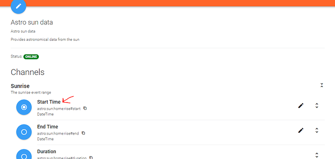

The channels don’t appear in the items, they appear in the things

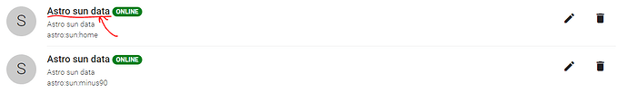

Configuration>Things - Click on the thing and the channels will be there
You can then link the channel with an item

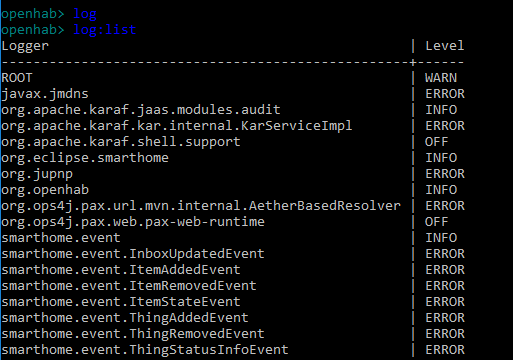

I’ve opend the log after i opend Things.
The are two warnings: No errors.
These are the warnings:
2018-10-24 14:19:58.508 [WARN ] [ome.core.thing.internal.ThingManager] - Initializing handler for thing ‘yamahareceiver:yamahaAV:9ab0c000_f668_11de_9976_ac44f2434f94’ takes more than 5000ms.
2018-10-24 14:20:02.756 [WARN ] [gcal.internal.GCalPersistenceService] - gcal-persistence:calendar_name must be configured in openhab.cfg. Calendar name or word “primary” MUST be specified.
