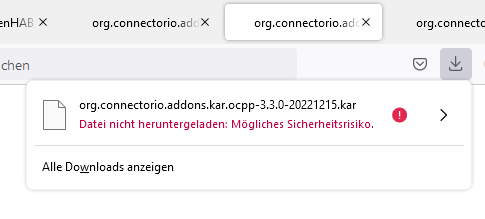

One thing which I have been wondering about my OH3 version. When I start OH3 the Karaf window says 3.3.0 but in Help & About page in the MainUI the version seems to be 3.2.0. I had to install OCPP version 3.2.
Can you tell me how an kar file can be added in OpenHAB, normally I have jar files.
kar files are a “collection” of jar files ( see KAR ).
They can be added in the same way as jar files.
Indeed, main difference is - KAR files can ship more JAR files than just one. They supplement local “system” directory with more libraries if needed. Please be aware that binding just launches OCSP 1.6J server to which charging station can be connected. It does not offer much beyond that.
