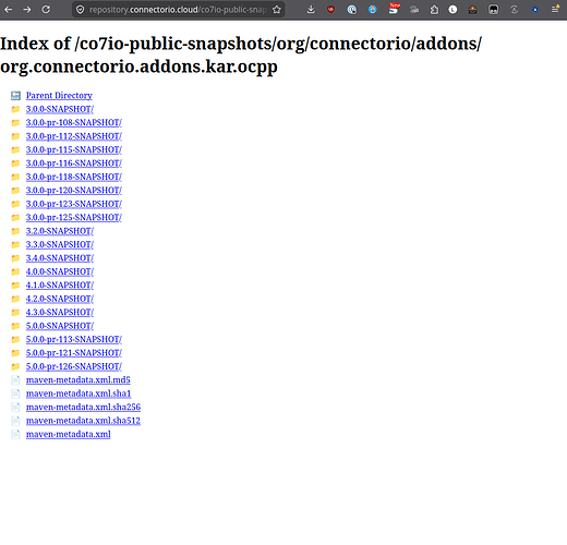

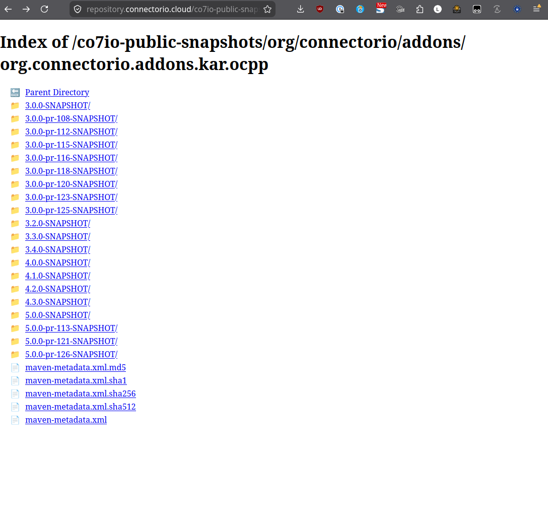

I’m getting an error when trying to follow that link.
I’ve updated link, it got some extra characters. KAR files are still there.

Indeed, links have changed due to phasing out previous repository manager, please use this link: ConnectorIO Binary Artifacts Repository.
I gonna update links in first post, so they will point to valid artifacts. There is one more pull request from @PRosenb which I should include in next successful deployment (infrastructure updates ongoing).
