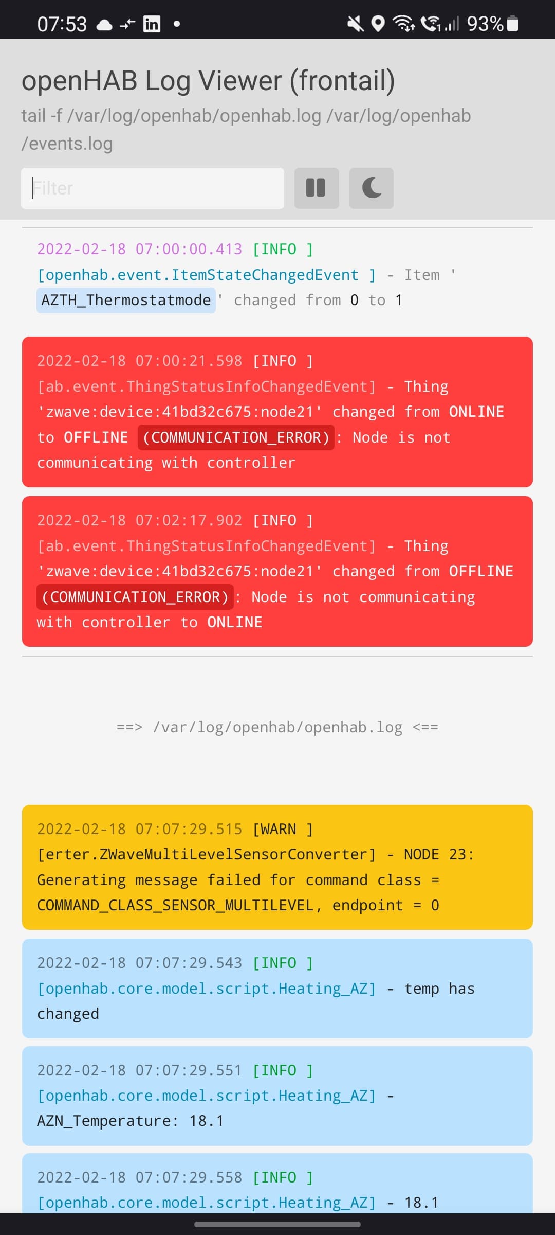

This morning I have a trouble bringing behaviour. My working room stays cold, cause by heating is not working.
In the morning with a calendar event the thermostat changes from night to heat.
So what happens. In the the the calendar event appears the zwave device seems to be offline.
So error was, see attached picture, could not communicate.
30 mins later, I reconize that it is to cold, I switch manual to heat and everything works.

Have a look at the logreader binding: Log Reader - Bindings | openHAB
With e.g. custom pattern search you should be able to identify such kind of messages and trigger a rule.

In my special case I found the device offline in the the log. The question is what a zwave device gives back as a status if it is offline.
