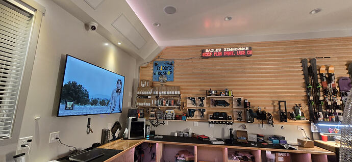

I blend the Chromecast plugin with the AndroidTV (GoogleTV) on my garage setup as well. Chromecast gets better casting details (whats playing, if its idling or not) ad i mostly use the GoogleTV power status to help with turning my TV’s on/off.
Forgot to add, i created a WLED matrix LED sign, when i’m playing music to the Chromecast, i grab the artist and song title to be displayed on the WLED sign:
