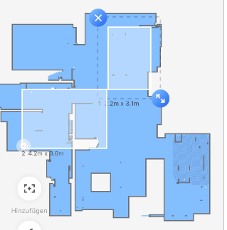

And some Switches for the Zones
Switch	HH_EG_ZO_esstisch  (gSaugSwitches)
Switch	HH_EG_ZO_arbeitsflaeche  (gSaugSwitches)

esstisch=-8.9,2.2,2.8,2.5,1
arbeitsflaeche=-4.2,1.3,4.2,1.3,1
grundreinigung=esstisch,arbeitsflaeche

val Functions$Function1<String, String> getZoneCoordinates =
[zone |
  var parameters = zone.split(',')
  // Docking point start position
  val double x = 25500.0;
  val double y = 25500.0;
  // Bottom (y) left (x)
  val double b = Double::parseDouble(parameters.get(0)) * 1000.0 + x
  val double l = Double::parseDouble(parameters.get(1)) * 1000.0 + y
  // Top (y) right (x)
  val double t = b + Double::parseDouble(parameters.get(2)) * 1000.0
  val double r = l + Double::parseDouble(parameters.get(3)) * 1000.0
  // Build zone coordinates (and number of times to scan)
  val coordinates = String::format("[%.0f,%.0f,%.0f,%.0f,%s]", b, l, t, r, parameters.get(4));
  coordinates

rule "Vacuum Zone control"
  Item Vacuum_Zone received command
	logInfo(logName, "Vacuum command: {}", receivedCommand.toString)
	// The final command send to the vacuum
	var String command = ""
	// Get zone coordinates
	var String zone = transform("MAP", "Rocky_Etage.map", receivedCommand.toString)
	// We still don't know if this is single or multiple zone
	try {
	  // Single zone only have numbers
	  command = getZoneCoordinates.apply(zone)
	} catch (Throwable t) {
	  // This is multi zone
	  parameters.forEach[string z|
		zone = transform("MAP", "Rocky_Etage.map.map", z)
		command = command + getZoneCoordinates.apply(zone) + ","
	  // Remove last ','
	  command = command.substring(0, command.length - 1)
	command = String::format("[%s]", command)
	logInfo(logName, "Clean {} zone coordinates {}", receivedCommand.toString, command)
	Rocky_ExecuteCommand.sendCommand('app_zoned_clean' + command)

I have created all the items as described.
All switches have the same principle as described (HH_EG_KU etc.). If I set a switch to on, it is not set to off afterwards.
About your help I would be very grateful
I was able to solve the problem. I had created the group incorrectly.
Now I have the problem, when I want to clean a zone, the vacuum goes offline. Is there something wrong with the conversion of the coordinates?
Map:
Esstisch=3.8,3.0,2.1,2.9,1
state of the item: app_zoned_clean[[29300,28500,31400,31400,1]]
currently I cannot help you. I had to re-installed and now I am also not able to update the binding to snapshot anymore. Apparently the snapshot-version needs 3.1
Therefore I am stuck with the old binding and cannot use my own rule.
How dd you solve the problem regarding installing the binding?
Unfortunately there are some breaking changes in the dependencies (the gson library version is changed in oh3.1) which is causing that indeed the 3.1 snapshot version binding is not usable in 3.0.
I am not (yet) brave enough to install snapshot 3.1 :slight_smile:
Perhaps someone installed the binding prior to the breaking change and/or can provide a link to the older Version? That would help me :innocent:
[Edit] I felt lucky today and now I am on M4. Everything works now
can you show the log file?
Please ensure, that in the third line of the rule, you configure:
var loggingInfo = true
in order to see what is happening.
i have completely updated openhab to snapshot
here is the log:
2021-05-05 21:27:27.098 [INFO ] [org.openhab.core.model.script.Rocky ] - Go to your room Los gehts zu Zone Esstisch
2021-05-05 21:27:27.106 [INFO ] [org.openhab.core.model.script.Rocky ] - Vacuum command: Esstisch
2021-05-05 21:27:27.125 [INFO ] [org.openhab.core.model.script.Rocky ] - Clean Esstisch zone coordinates [[29700,28500,32000,31700,1]]
and then the vacuum goes offline:
2021-05-05 21:27:27.853 [INFO ] [ab.event.ThingStatusInfoChangedEvent] - Thing 'miio:vacuum:64ee8a7d53' changed from ONLINE to OFFLINE (COMMUNICATION_ERROR)
the excerpt from the map looks like this:
Esstisch=4.2,3.0,2.3,3.2,1
and the item is called:
HH_EG_ZO_Esstisch
Karte
my card looks like this
Might be the binding… Perhaps @marcel_verpaalen can help you.
Just to recap:
item:
String Rocky_ExecuteCommand   ... linked to miio:vacuum:xxxxxxx:actions#rpc
command
Rocky_ExecuteCommand.sendCommand("app_zoned_clean[[29700,28500,32000,31700,1]]")
result
Thing 'miio:vacuum:xxxxxxx' changed from ONLINE to OFFLINE (COMMUNICATION_ERROR)
That is correct!
Do I have to select “Cloud” for Communication Method in the thing?
When I do this, the vacuum goes offline.
No, the cloud option should be avoided if possible. Local communication is faster, more secure and more stable. Only if there is real need for cloud connectivity (e.g. your device is in different network, or does not support direct (e.g. gateway v3)) then you would enable cloud connectivity.
Now it works. I have entered my access data for the cloud in the configuration of the binding and selected “Cloud” for the communication method.
Edit: Communication method “Cloud” does not have to be selected.
