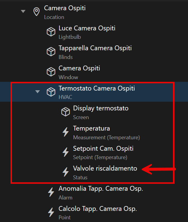

With the transition from OH4 to OH5 the “climate” icon no longer appears in the cards.
Referring to this:

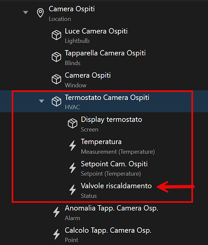

Has something changed or is it a bug?
Others, like lights/open windows/etc, work fine.
This is one “Location” configuration and the HVAC with the Status item:
Thanks!

I think the issue is related to the changes made to tags and location cards in OH 5. If I interpret the changes in https://github.com/openhab/openhab-webui/pull/3245 correctly, for climate the item now has to additionally be tagged with property Power to be recognized by the card. AFAICT from your screenshot, this is missing in yours.
Sim
(Sim)
December 3, 2025, 3:55pm
8
Oh, that fixed it!
Thanks, I’m closing the bug and reporting the effect.
Power…? Heh… Now that’s a curve ball I wasn’t expecting but yeah I can confirm, added a switch item with power and sure enough it appears.
I use AC for both heating and cooling and I switch modes with a string item…
Crap
