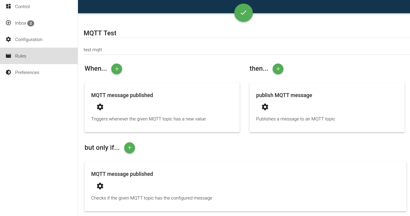

This is how the not yet included integration of MQTT in the new Rule engine looks like:
There is no documentation for this yet.
