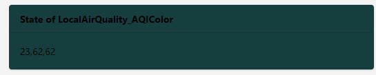

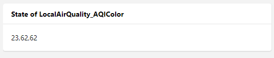

I’m trying to play with OH3 and I stuck in the simple custom widget
I have AirQuality Binding which and related Color type Item LocalAirQuality_AQIColor.
I try to use value of this Item as the background color in custom widget. Unfortunately with no success

Could somebody provide me a sample how to us it correctly?
