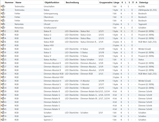

I use OH 2.3 KNX2 and a Enertex KNX actor.
Attached you can see the avaiable objects from the knx actor.
Anyone have any idea to solve this issue?
afaik openHAB2.3 stable has no support for color channels in knx2, but 2.4.0-M7 has (and of course 2.4 nightly). Or wait until OH2.4 stable is out.
knx2 does support DPT 232.600 - this is communication object (CO) 17 and CO 31.

Maybe you can post the lines to use in things, items and in the rule?

I try with the following two options in things but is the same result
Type color : bad_led “Farbe” [ hsb=“232.600:3/1/21+<3/1/22”, switch=“1.001:3/1/1+<3/1/2” ]
or
Type color : bad_led “Farbe” [ hsb=“232.600:3/1/3+<3/1/4”, switch=“1.001:3/1/1+<3/1/2”, position=“5.001:3/1/17+<3/1/18”, increaseDecrease=“3.007:3/1/15+<3/1/16” ]
I do something wrong or there is a bug?
