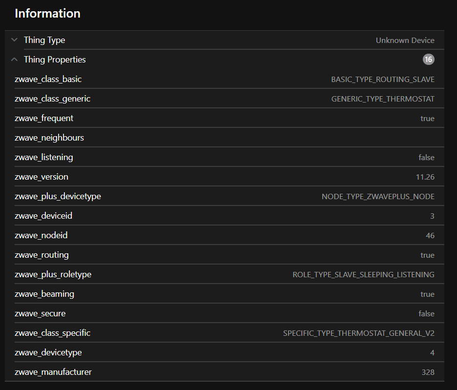

I recently bough a new z-vawe Thermostat from EUROTRONIC. I have old one (Spirit) which is working perfectly with my OH3.4 on Raspi 4.
Unfortunately I can not receive all data to the controler. The device is unknown. Even after pressing shortly preset button inside the battery space I can not retrieve more information.
Does someone have experience with this device

Would reinitialise or heal device help?

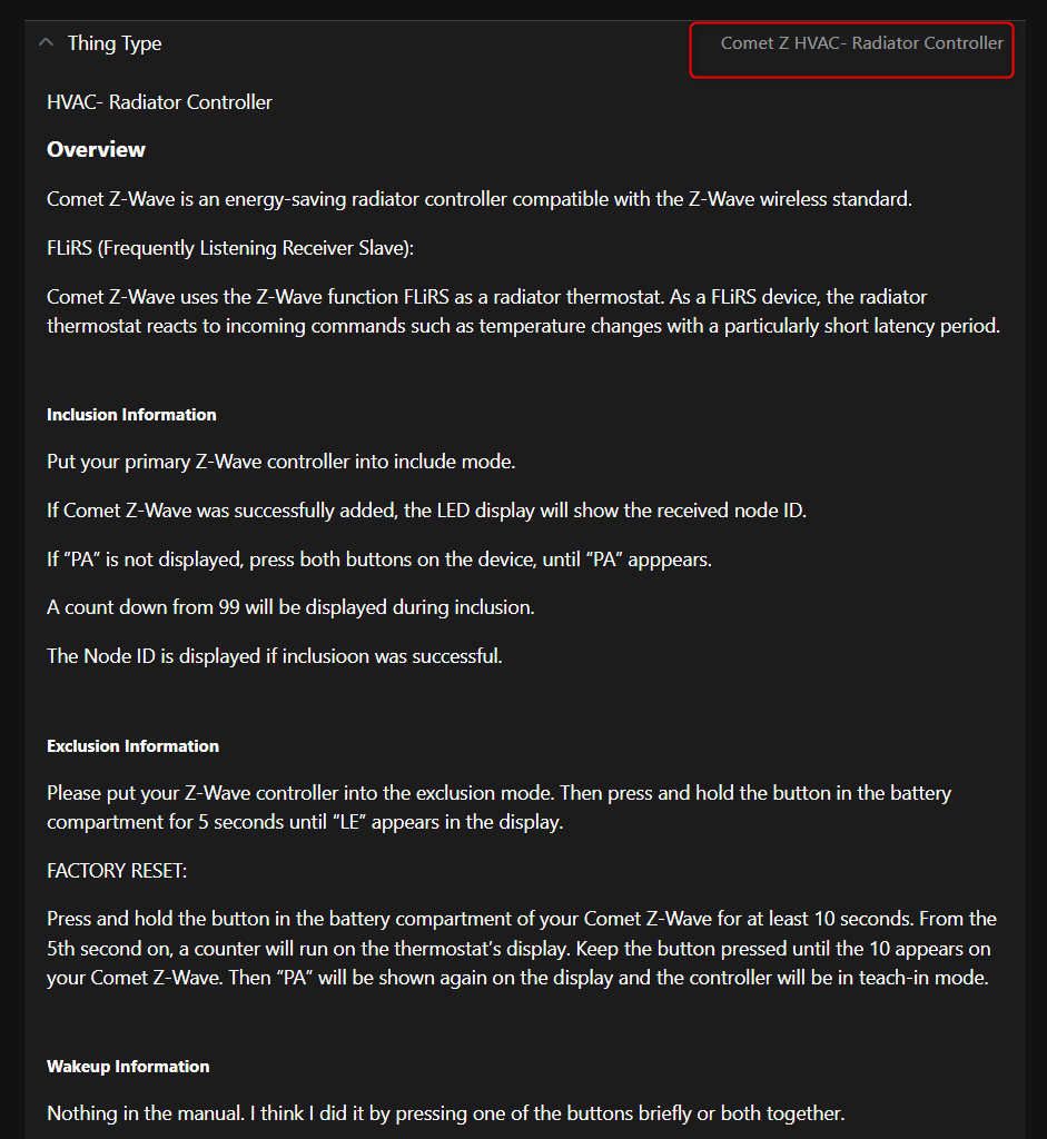

The device is in the DB, but I think had a period when it was modified and dropped. What version of OH4 are you on? could try the latest 4.1m3.
I am still with OH3.4.2
Well that explains it. Upon further review it should be available on the stable OH4.
The other option is to follow this guide to update your OH3.4.2 zwave binding.

Update to 4.0.4 (latest stable) seems to solve the problem.
@apella12 Many Thanks!
