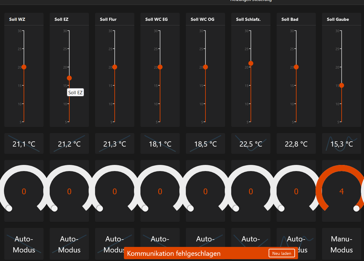

I have an Installation with Homematic Thermostates and developed a page which was working fine with OH3.4
Now I updated to 4.0 and get an “Communication Error” in the Frontend when updating the Temperature by clicking on the slider.
It works also fine in “RunMode” but not in the normal Mode.
Unfortunately I got no faliure description in the log,
Any hints to solve the problem?
Best regards Matthias
I think I’ve seen some issues reported that the websocket or SSE feed doesn’t always work correctly in HTTP. Have you tried the HTTPS port to bring up MainUI?
I tried it and it works, Thank you
