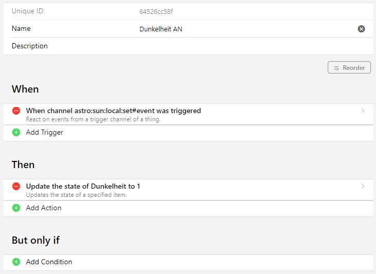

Great input from both of you guys! Thanks for that :slightly_smiling_face:
I took Wolfgang_S’ idea to create an item “Dunkelheit” (darkness) which is on state “1” once the sunset event has been triggered (and set to state “0” once sunrise fires).
I have not tested the script yet, but hopefully it will do it’s job
