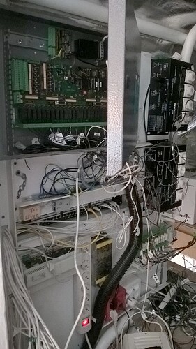

What I would like to do:
  • have all the function my previous home-control system knew before it broke. (Short+Long press, long-dimming, temperature + light, rules, scenes = moods, roller sh., timers.)
  • and extend with some new functions. (Tablet + mobile GUI, maybe voice control, IR control, etc)
  • Having lot’s of cheap inputs and outputs (min. 64+48)
I need this USB>I2C cable because the Raspberry will be at my Bedroom (at 24.5 °C) but ALL the wires and dimmers and relays are at the attik 2 meters above it:
IB = Intelligent Building or Home automation if you like. One more thing, why USB to I2C when you have I2C on GPIO?
Does it have to be? The chips you are using have an interrupt output that would make it much easier to do. I can get MQTTany to handle everything you want if we can access the interrupt signal from the chips directly. You say you don’t want the Pi in the attic or any direct GPIO connections, but if you want this level of real-time response you won’t be able to do that. If what you really want is the galvanic isolation so that a lightning strike doesn’t take your system down, putting the Pi in your bedroom and connecting via USB won’t protect it.

Connecting the PCF8574s
Option 1
Connect the PCF8574 via opto-couplers to the I2C port of the Pi (I can provide circuit diagrams if needed) and connect each PCF8574s interrupt pin via opto-coupler to a different GPIO pin on the Pi. Now we have direct connection with the Pi so we can get close to the response speed you need, and we have the galvanic isolation you want in case of lightning strike. You will also need a separate power supply for the PCF8574s, but fewer opto-couplers. (make sure you surge protect the input to the power supply for the Pi!)
Option 2
Connect the I2C and interrupt pins directly from the PCF8574s to the Pi and power them from the same supply. Place opto-couplers on every input/output from the PCF8574s. This method is simpler but requires an opto-coupler for every input/output pin.
Software
MQTTany can already handle MCP230xx devices (same type of IO expander) and I had planned to add support for listening for interrupt signals from them.
If I add the PCF8574 support and interrupt handling, the only thing missing is your direct dimmer control. It is probably possible in MQTTany if I build some custom code for you, but I need to know how your dimmers are controlled.
