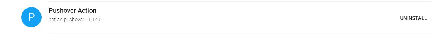

  • sendPushOverMessage & pushoverBuilder → is there a certain binding needed as it throws errors?
exactly it is Action for sending info to smartphone:

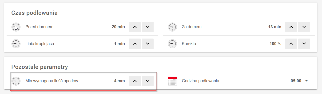

I disabled all relevant rain sensor linesand it looks good for the moment. However the
MinimumReqRainfallCfg is confusing me. It still throws errors.
Please see screenshot
Could you please also share your sitemap file?
I created the rain amount inpout based on your screenshot, but it doesnt look right.

This problem is solved, i deleted for some reason the MinimumReqRainfallCfg item in the itmes file.

I use pushover to send message to my smartphone (you need to install pushover software on your mobilephoine).

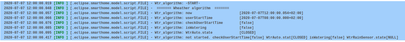

Hi @Michal_Szymanski,
i’dlike to ask you once more for support if i may.
So far i have configured the system, replaced the start button with a virtual one and removed the rain sensor. However, it never made it to the weather forcast section of the algorythm. Please see log:
Any ideas why this occures?
Answer is simple :slight_smile: This log is from 12:00 but watering time is 8:00 ..be patient or change userStartTime.
This rules check watering condition every hour but start only once during the day in your situation 8:00

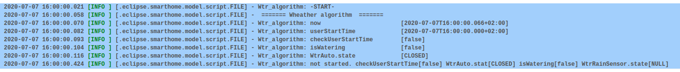

I know! I Set it initially to 8:00 Last night. But it didnt start at all. I also tried any other date. Nothing. Could it be the checkuserdate - which I also set to true and false and vice versa ?
I’ll set it to 16:00 and post again the outcome.

So same thing.
I changed to 16:00
